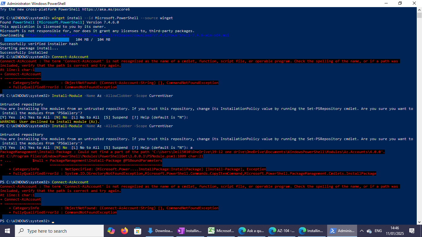

Hello,
I am not able to connect to my Azure account via Powershell. I first used winget to install PS 7 and then used Install-Module -Name Az -AllowClobber -Scope CurrentUser to further the installation. Is this correct? Attached is the screenshot.
Thanks
Marouf

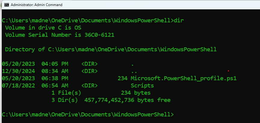

    It looks like you did "something" with OneDrive .
    You've got too many folders in there. The directory should be C:\Users\Dell5010\OneDrive\Documents\WindowsPowerShell.
    Like this.
    I would expect you to be having problems with OneDrive, so you might want to get that fixed first. You might need to uninstall/reinstall. I don't know what you did or why.
    You could try using "Install-Module -Scope AllUsers", but that won't fix OneDrive.
