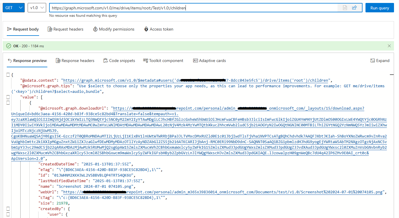

I’m trying to retrieve the children of a folder named v1.0. The response is a 404 error.
According to the instructions here, the request should be GET /me/drive/items/root:/Test/v1.0:/children
Interestingly, when the folder name is v1.1, the children are correctly retrieved.

    Hello Jareth Lomson,
    Thank you for reaching out to Microsoft Support!

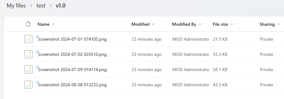

    After our test, when the folder name is v1.0, it runs well, and the test results are as follows:
    Screenshot 2025-01-13 015820

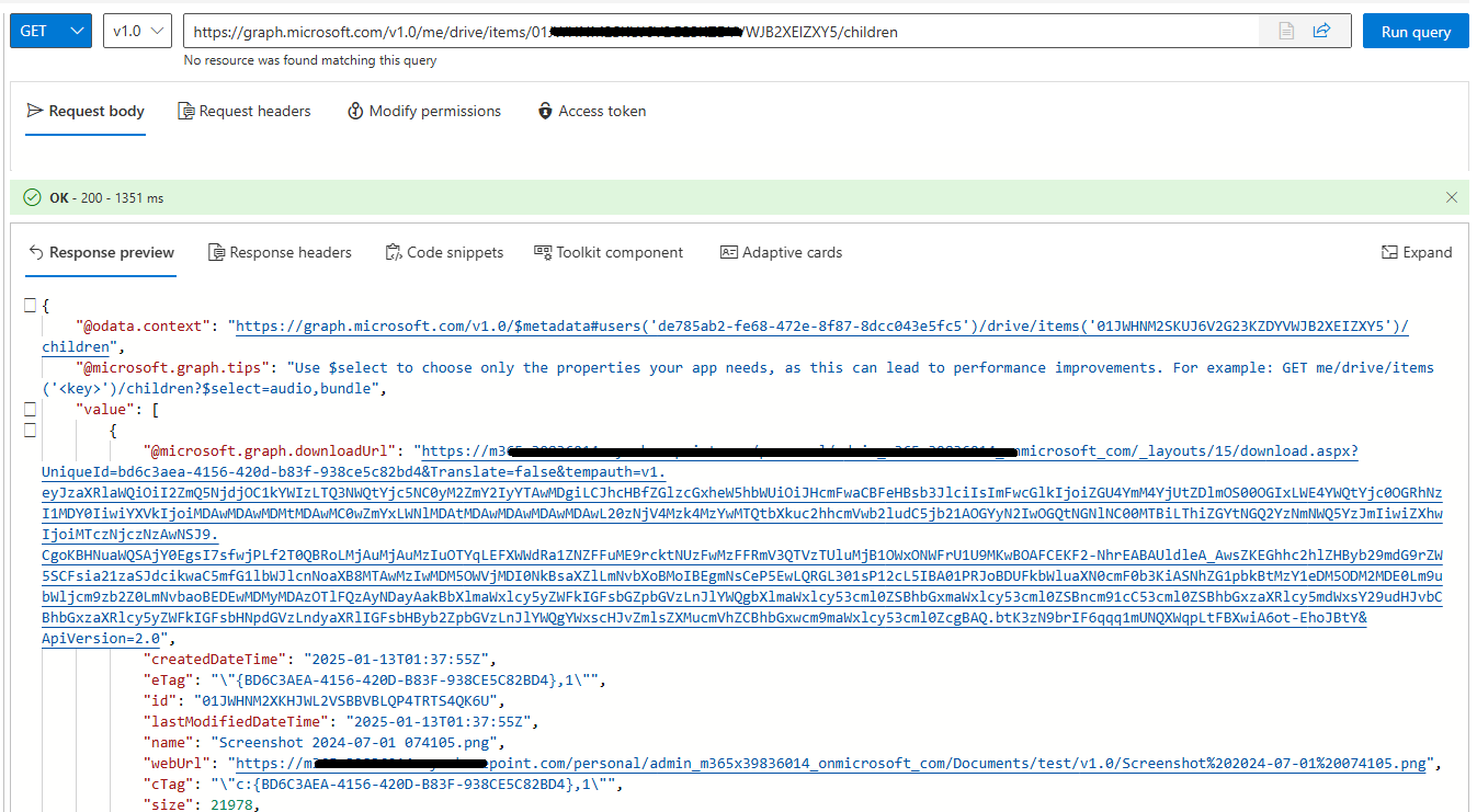

    Please try again, or use the id of the item to get the children, as follows:
    Screenshot 2025-01-13 020223
