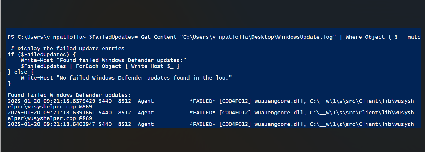

    Q1) Maybe from Windows Event?
    A) The steps which I have provided by using from Windows Event, As per your Request from Automation you can achieve this by creating Hybrid Runbook Worker
    • Create run book and add the provided script .
      Please find the Reference below for script.
      https://learn.microsoft.com/en-us/azure/automation/automation-hybrid-runbook-worker

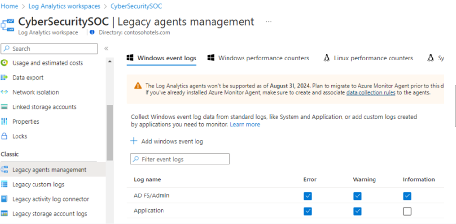

    Q2) Will Azure Monitoring Agent be able to get this type of information?
     A) Yes, you can collect the logs. Windows Defender writes logs in the Application log. You can also enable additional logging features for reference. See the details below:
    The below script is for reference, Modify as per your Requirement
    Event
    | where Source == "Microsoft-Windows-Windows Defender" or Source == "Microsoft-Windows-Windows Defender Antivirus"
    | where EventID in (1006, 1010, 2001, 5007)
    | project TimeGenerated, EventID, Source, RenderedDescription, Computer
    | order by TimeGenerated desc
     Please find the Reference MS doc below.
     https://learn.microsoft.com/en-us/azure/azure-monitor/agents/data-sources-windows-events#configure-windows-event-logs
