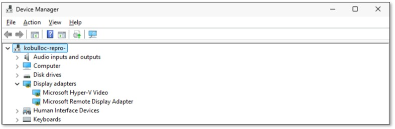

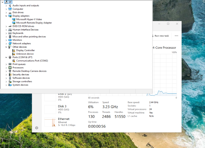

Hope you are doing well. I created an Azure VM with Windows 11 using Standard NC24ads A100 v4 (24 vcpus, 220 GiB memory) but I am not able to find any GPU device attached. I already installed an extension but I am not sure why I can't find GPU and even on Device Manager, I am not able to find anything.
I'd appreciate it if someone takes a look at the screenshots below and help me use GPU on my NC-series Azure VM.

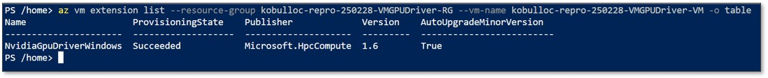

    Hello, @Williams Roger ! Summarizing what we've discussed:
    Why am I not seeing a GPU in the device manager after installing drivers on my NC24ads A100 v4 VM?

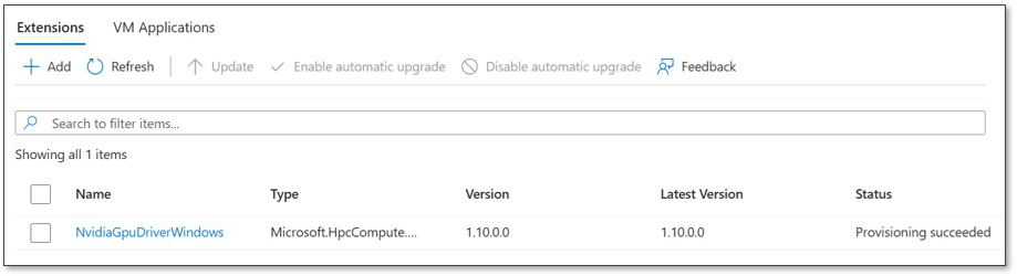

    In this instance, while the driver install process is successful, the enable process is not. This is an issue on our end that affects the CUDA drivers on NC A100 SKU VMs.

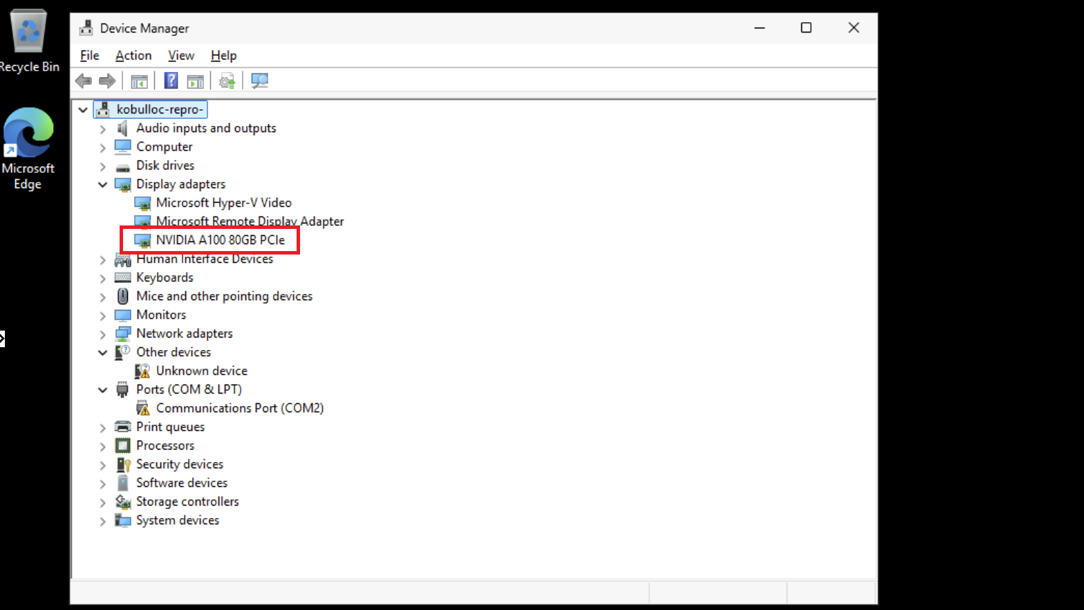

    Edit (3/13/25): The fix is live and you should now be able to deploy the NVIDIA GPU driver extension without issue:

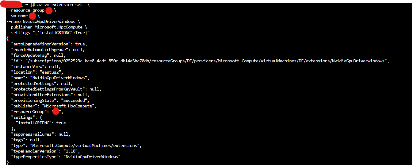

    As a temporary workaround, you can try GRID drivers instead of CUDA drivers. For installing GRID Drivers on NC SKU VMs, you need to use Azure CLI and an ARM template:
    az vm extension set  \
    --resource-group <resource-group> \
    --vm-name <vm-name> \
    --name NvidiaGpuDriverWindows \
    --publisher Microsoft.HpcCompute \
    --settings "{'installGRIDNC':True}"
    ARM Template:
      "name": "NvidiaGpuDriverWindows",
      "type": "extensions",
      "apiVersion": "2015-06-15",
      "location": "<location>",
      "dependsOn": [
        "[concat('Microsoft.Compute/virtualMachines/', <myVM>)]"
      "properties": {
        "publisher": "Microsoft.HpcCompute",
        "type": "NvidiaGpuDriverWindows",
        "typeHandlerVersion": "1.9",
        "autoUpgradeMinorVersion": true,
        "settings": {
             "installGRIDNC":True
    You can use nvidia-smi to confirm installation at this point.

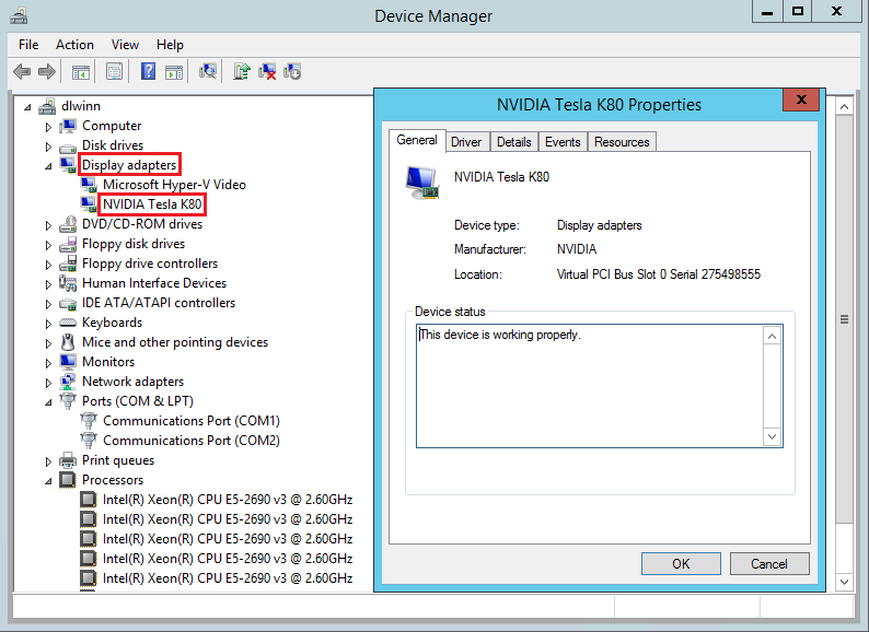

    It is expected that after installing the NVIDIA GPU Driver Extension for Windows on your Standard NC24ads A100 v4 VM, you should be able to verify driver installation in the device manager:
    https://learn.microsoft.com/en-us/azure/virtual-machines/windows/n-series-driver-setup#verify-driver-installation
