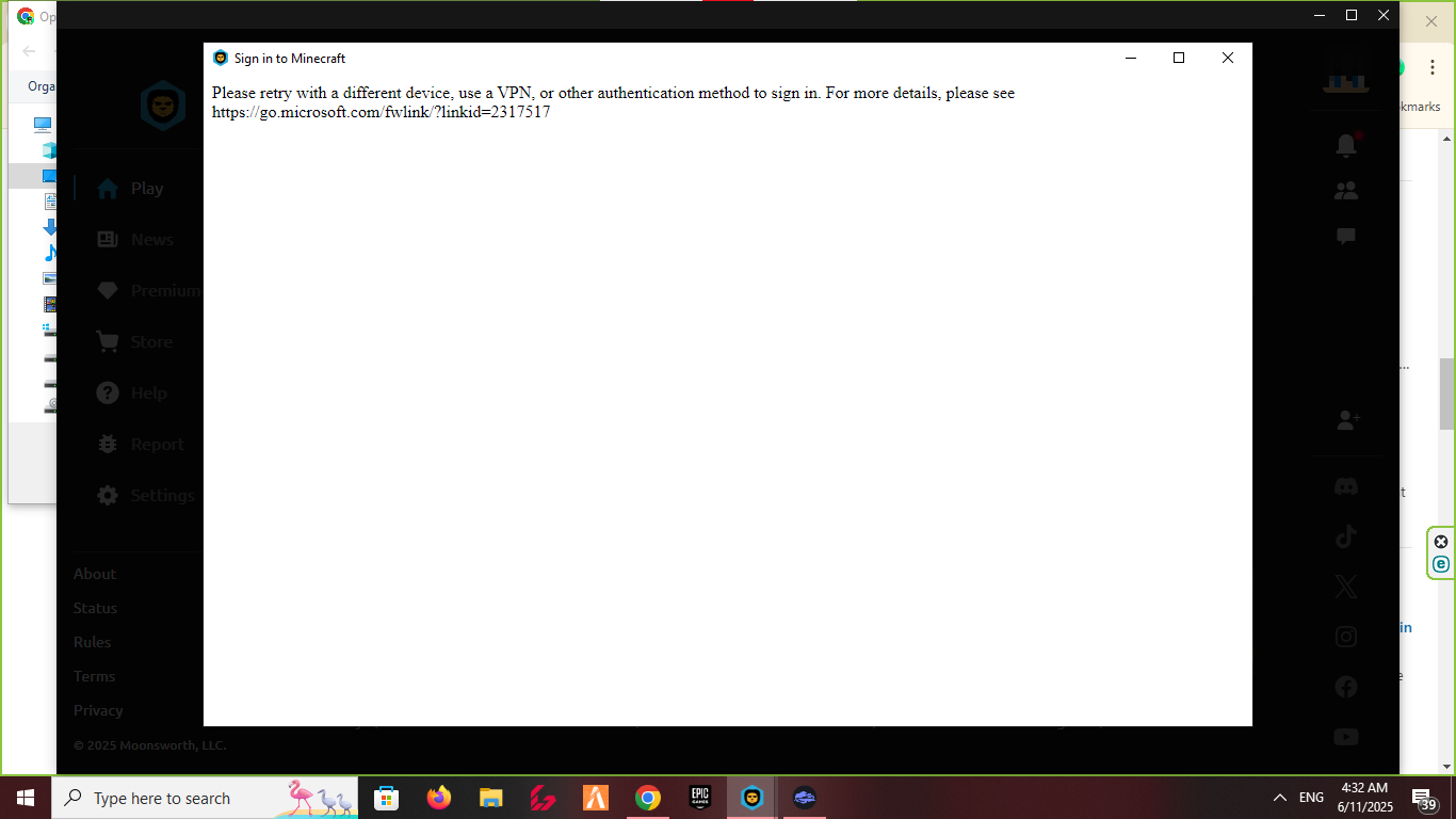

ARNO 100K • 0 Reputation points
2025-06-11T16:11:44.3633333+00:00 when i login my id then show this error
Please retry with a different device, use a VPN, or other authentication method to sign in. For more details, please see https://go.microsoft.com/fwlink/?linkid=2317517
plz fix this

Greek Specialist • 5 Reputation points
2025-06-11T07:36:38.31+00:00 Good morning. I followed thw procedure to run the 'netsh winsock reset' and the other one mentioned here from other members and after this the problem of access to my hotmail account resolved. Next day I noticed that my laptop with win10 home started to deisconnect fron the router by wifi and do not recognise the router anyway. I tried a lot but it works only when I connect it with a cable. Can somebody help meto to recover my windows from this wrong situation? Thanks in advance.
