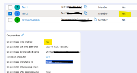

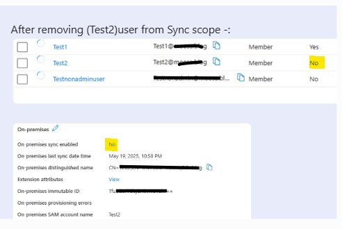

    However, if you need to a specific user to a cloud-only , you can follow this alternative approach:
    1. Move the user to an Organizational Unit (OU) that is not included in the sync scope.
    2. Run a delta synchronization (Start-ADSyncSyncCycle -PolicyType Delta).
    3. After the sync, the user will appear in the Deleted Users section of the Entra ID portal.

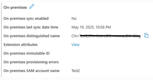

    4. Restore the user from the Deleted Users list. Upon restoration, you'll notice the on-premises property is set to “No”, indicating that the user is now cloud-only.
    Recommendation: Please test this process with a non-production user account first and also recommended to perform these changes outside business hours to avoid service interruptions.

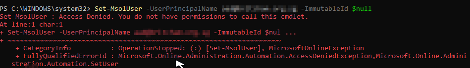

    Regarding error of "Access denied" is because MSOL has been depreciated try using the Graph API or the mggraph cmdlets.
    Action required: MSOnline and AzureAD PowerShell retirement - 2025 info and resources | Microsoft Community Hub
    If you want to clear the immutable ID here are the commands below-:
    Install-Module Microsoft.Graph -Scope CurrentUser
    Import-Module Microsoft.Graph.Users
    Connect-MgGraph -Scopes "User.ReadWrite.All"
    Invoke-MgGraphRequest -Method PATCH -Uri "https://graph.microsoft.com/v1.0/Users/******@xxxx.xxxx" -body '{"OnPremisesImmutableId": null}'
    Need to restore the user from deleted section After moving the user to Non Sync OU-:
    After using the above commands-:
