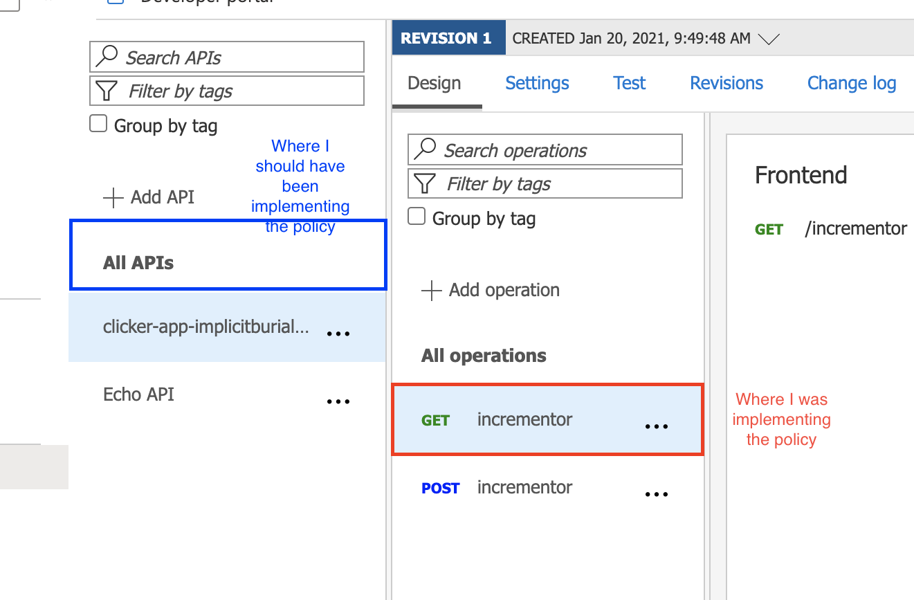

  1. Mark Potter 101 Reputation points
    2021-01-21T12:18:05.627+00:00
    Hey Mayank, thanks for coming back to me.
    I figured out what the problem was. I needed to implement the policy at the All APIs level, I was adding it to individual endpoints. I'll attach a screenshot to explain.59192-screenshot-2021-01-21-at-121243.png
