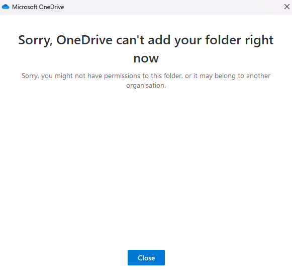

Hello,
I have a web application on SharePoint 2019 on-premise from which I try to synchronize libararies. The web application is extended to use FBA authentication.
When I'm connecting using the Windows Authentication, I'm able to synchronize libraries with OneDrive without problems.
But when using the FBA authentication to connect to the extended web application I'm not able to synchronize libraries. After entering my credentials OneDrive return me the following error : There was a problem connecting to OneDrive (Error Code: 0x8004de40).
Is there some additional configuration to be done to have OneDrive synchronization working using FBA Authentication ?
