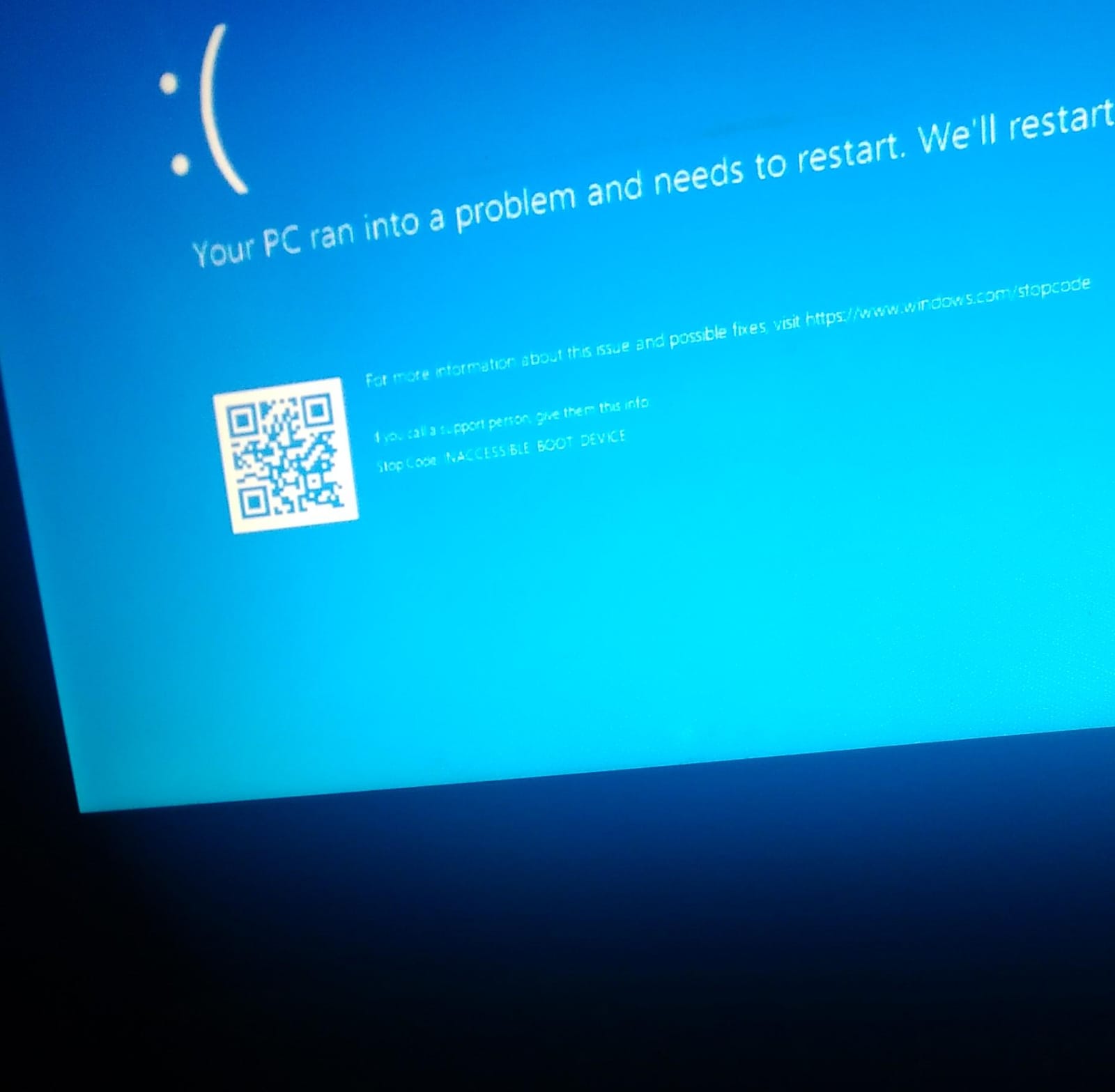

INACCESSIBLE BOOT DEVICE
BruceLilaGonzalez-5521 0 Reputation points
2026-03-15T10:17:28.7933333+00:00
IMG-20260314-WA0007
Windows for home | Other | Performance and system failures
  1. Ivan B 112.7K Reputation points Independent Advisor
    2026-03-15T12:47:14.72+00:00
    If it's a laptop or desktop, if possible, could you provide the laptop model or your desktop configuration?
    Can you access the BIOS, go to the Boot tab, take a picture and post it here?
    Thanks

    The INACCESSIBLE_BOOT_DEVICE stop error (0x7B) indicates Windows can’t access the system disk during startup. It’s usually caused by storage driver or controller changes, disk/partition corruption, or hardware problems.
