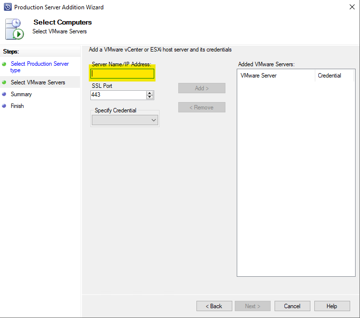

In the #8 in "Add the vCenter Server" section of the second URL, I typed the credential to login to the ESXi along with the section.
However the following error message appears.
Data protection manager Error ID: 33623
Internel error code: 0x80990EF2
