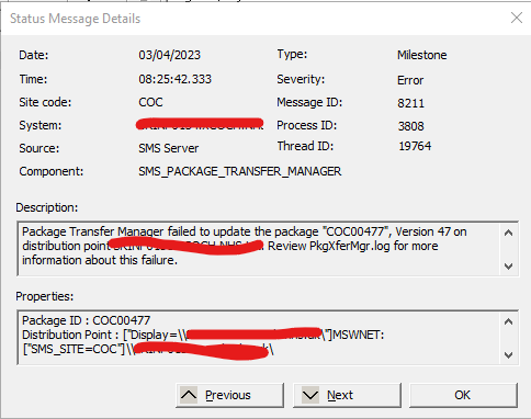

In the console we get the below message:
Package Transfer Manager failed to update the package "PACKAGEID", Version 11 on distribution point DP NAME . Review PkgXferMgr.log for more information about this failure.
Possible cause: Site server does not have sufficient rights to the source directory.
Solution: Verify that the site server computer account has at least Read access to the directory you specify as the source directory.

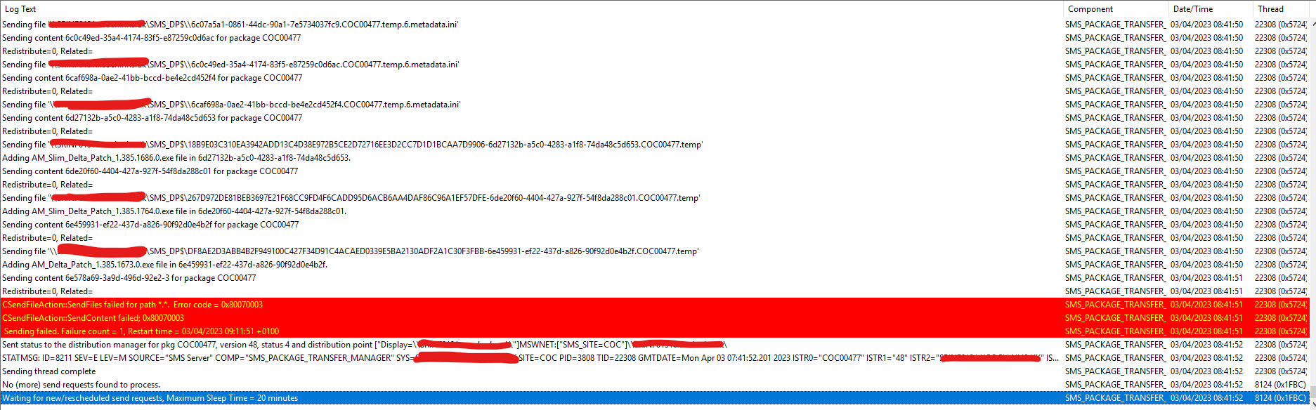

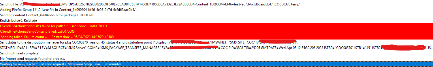

In the PkgXFerMgr.log we get the below message:
CSendFileAction::SendFiles failed for path .. Error code = 0x80070003 SMS_PACKAGE_TRANSFER_MANAGER 20/03/2023 09:25:35 43092 (0xA854)
CSendFileAction::SendContent failed; 0x80070003 SMS_PACKAGE_TRANSFER_MANAGER 20/03/2023 09:25:35 43092 (0xA854)
Sending failed. Failure count = 1, Restart time = 20/03/2023 09:55:35 -0000 SMS_PACKAGE_TRANSFER_MANAGER 20/03/2023 09:25:35 43092 (0xA854)

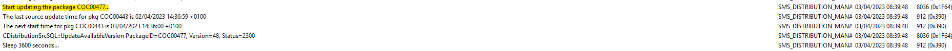

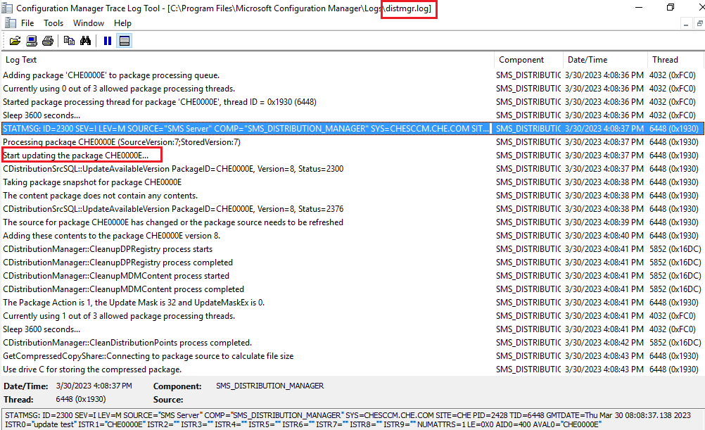

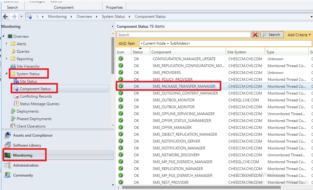

  2. CherryZhang-MSFT 6,496 Reputation points
    2023-03-30T08:30:42.9833333+00:00
    Hi @Kieran Brown COCH
    1, Please help check you SMS_PACKAGE_TRANSFER_MANAGER is healthy. The screenshot for your reference:
    1
    2, The Distmgr.log should be like this when we update the package, the screenshot for your reference:
    2
    I will be sharing for you if I have any update!
