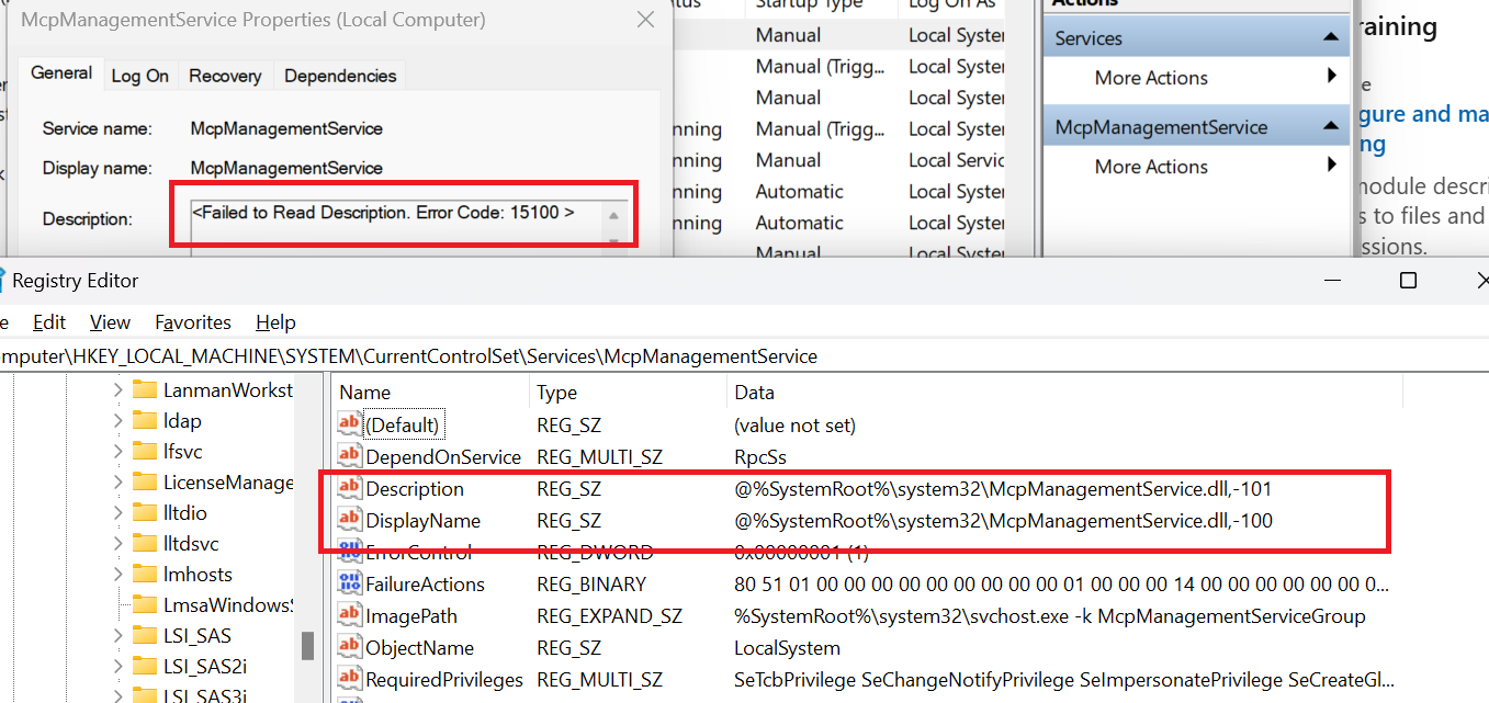

The service McpManagerService always generates the error code 1500. This is because of not having access to the mui language files.

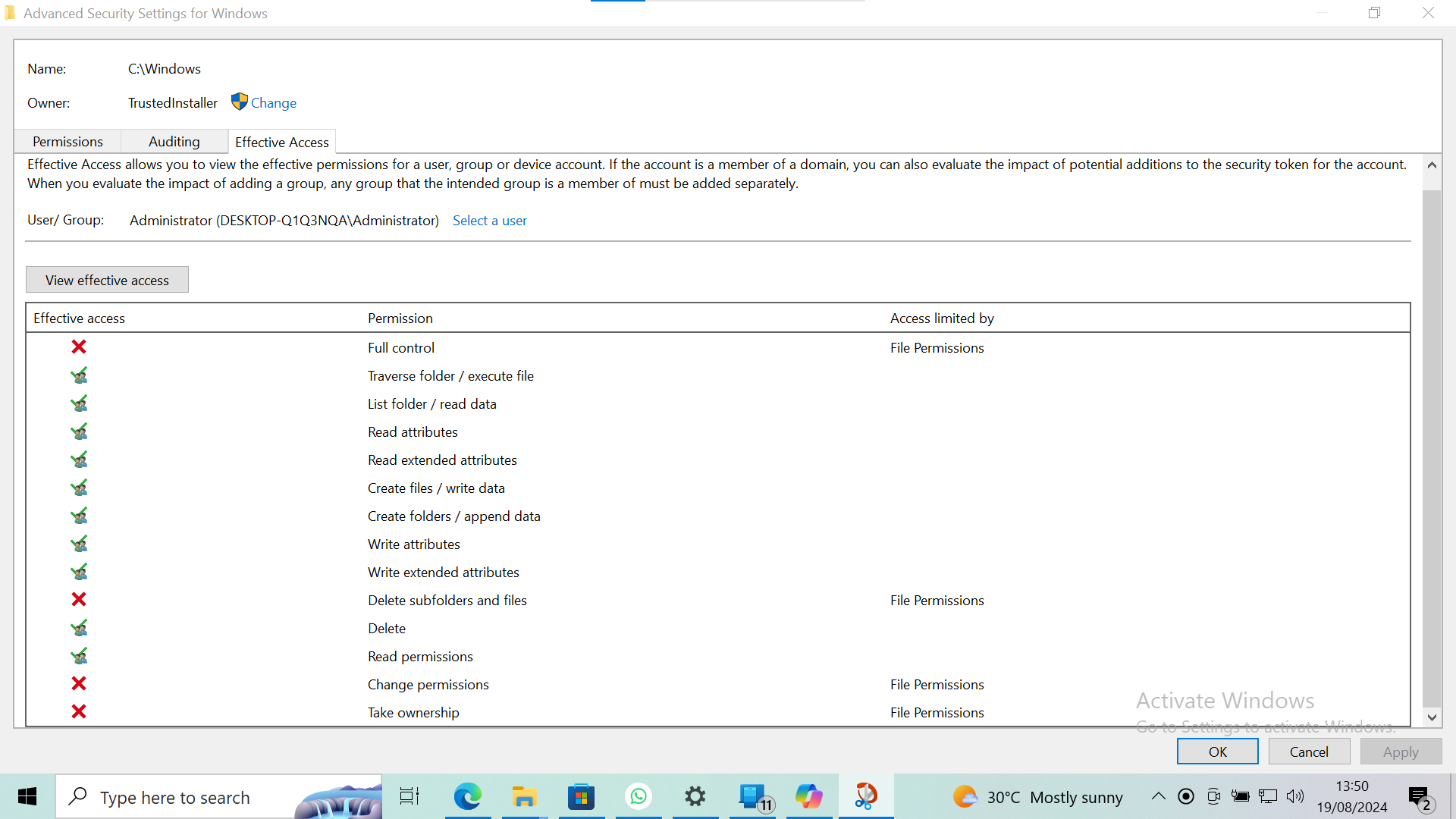

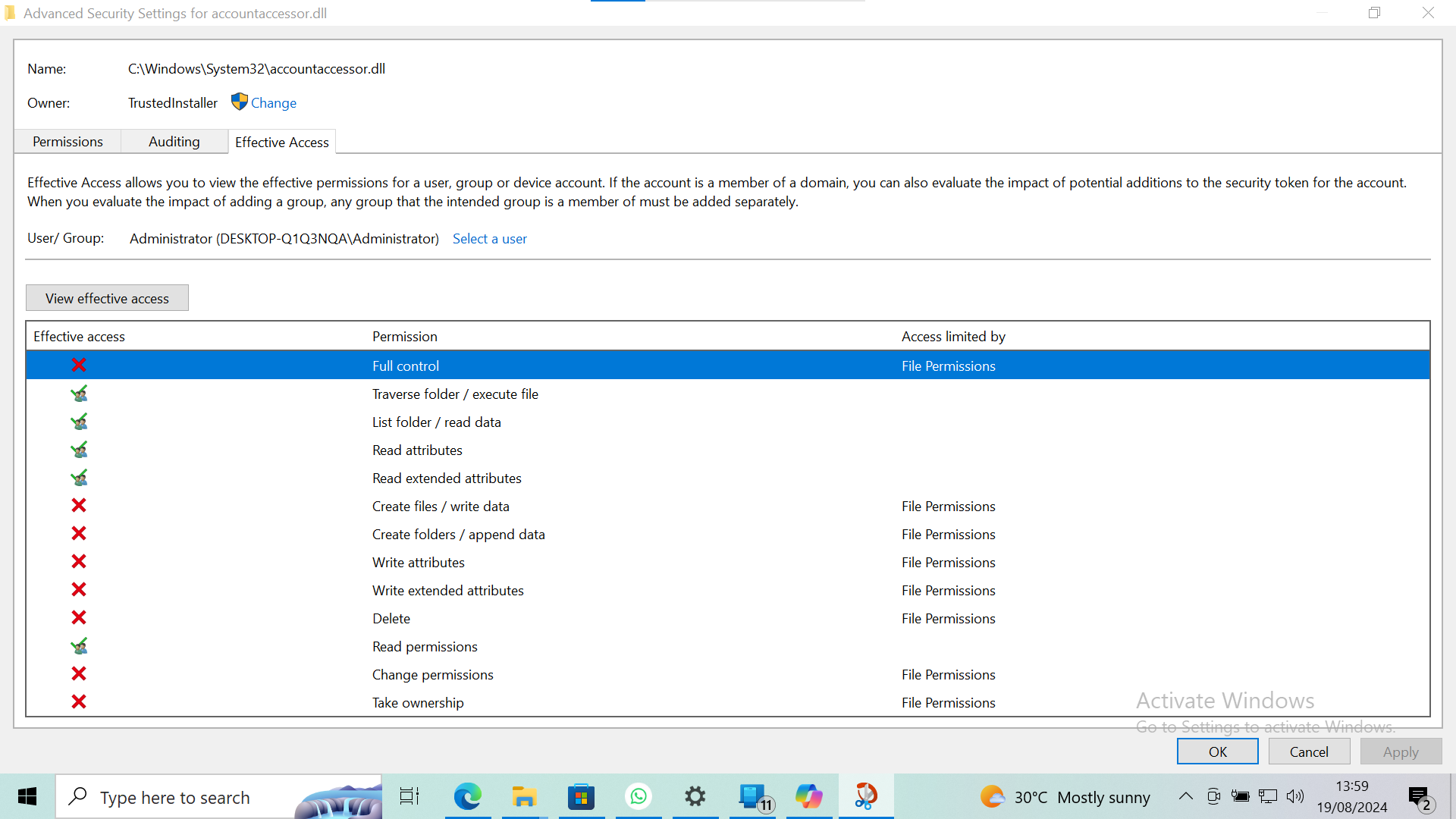

On further examinations I found out that on many essential system folders and files, the System and Administrators accounts don't have any permissions, for example on the folder C:\Windows\System32\ the security tab on properties of the folder the two accounts have no rights. Furthermore, it not possible to change them either.

I tried to run icacls command as suggested in the above link, but it failed on most files and folders. This could be because the Administrators group don't have adequate rights in the first place.

  1. XinGuo-MSFT 17,931 Reputation points
    2024-08-07T08:04:21.46+00:00
    Are you certain that you formatted and reinstalled the operating system disk? Typically, reinstalling the OS does not lead to permission issues.
    Should you face such permission problems, consider setting the ownership at the root directory level, as permissions will cascade to the subdirectories.

  3. MotoX80 33,481 Reputation points
    2024-08-10T14:54:08.19+00:00
    On my Win11 Home laptop I also see the 15100 error. But it does display the Display Name value which it also pulls from the dll. I would need to do more research on that, but I think that the explanation is that the -101 ordinal is not registered in the dll. (I believe that is the correct terminology.)
    I would think that you can just ignore that. It looks to be a minor oversight.

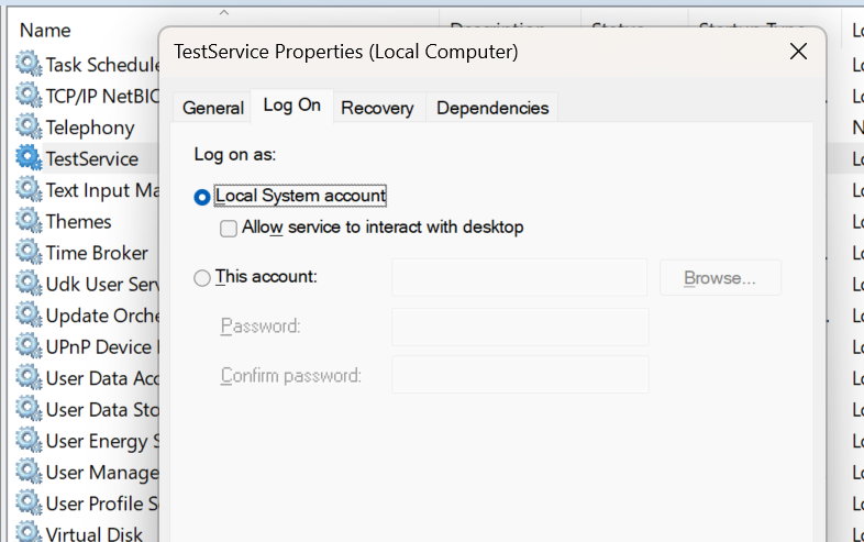

    To set a service to run as the system account, you would set it here.
    The services that have "_nnnnn" appended to them are "per user" services.

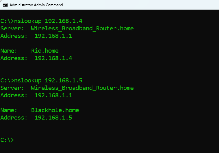

  4. MotoX80 33,481 Reputation points
    2024-08-23T15:01:59.4733333+00:00
    You need a Server version of Windows to run a DNS server service.
    https://learn.microsoft.com/en-us/windows-server/networking/dns/quickstart-install-configure-dns-server
    The DNS Client service is used to resolve DNS domain names, by querying locally cached information obtained from a previous query or by querying a remote DNS server.
    https://learn.microsoft.com/en-us/windows-hardware/customize/desktop/unattend/microsoft-windows-dns-client
    E.g. DNS service doesn't register anything, it is empty.
    Huh?
    "Ipconfig /displaydns" will display the cached names and addresses.

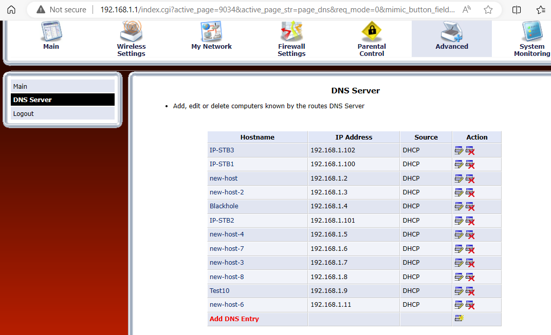

    On my home network, I have a wifi router at 192.168.1.1. It serves as the DHCP/DNS server. When any of my pc's boot they get an address from the router and their name is registered with it. The router calls external DNS servers to resolve names on the internet.

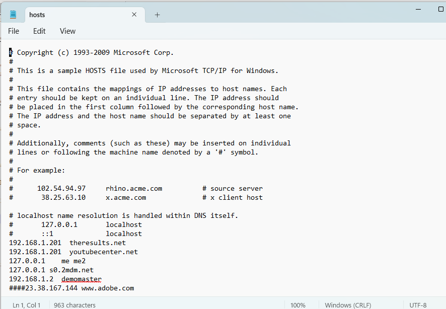

    I manually edited the hosts file to override DNS to block certain names that I found my pc accessing, and also to test stuff out. Administrators have full control.
    PS C:\Windows\System32\drivers\etc> icacls .\hosts
    .\hosts NT AUTHORITY\SYSTEM:(I)(F)
            BUILTIN\Administrators:(I)(F)
            BUILTIN\Users:(I)(RX)
            APPLICATION PACKAGE AUTHORITY\ALL APPLICATION PACKAGES:(I)(RX)
            APPLICATION PACKAGE AUTHORITY\ALL RESTRICTED APPLICATION PACKAGES:(I)(RX)
    If I needed to manually create an entry, I would use the routers web interface to do that.
    I would expect your router to have similar functionality.
    I was trying to setup a routing table to maintain routing between wi-fi devices and Ethernet devices.
    Are the ethernet devices plugged into your pc or the router? If they are plugged into your PC, then you could manually add an entry into the hosts file and use the "route add" command to define the network route over to the ethernet adapter and not use the wifi adapter.
