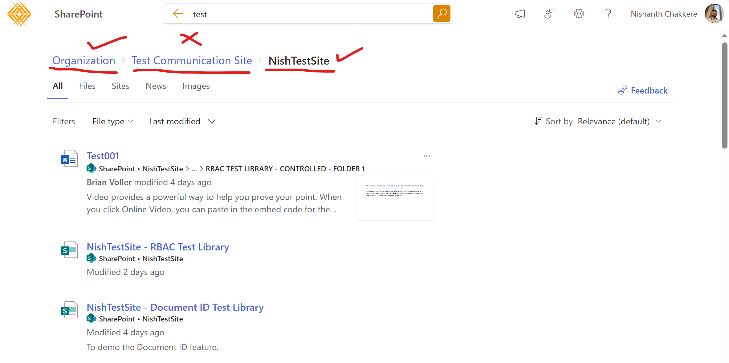

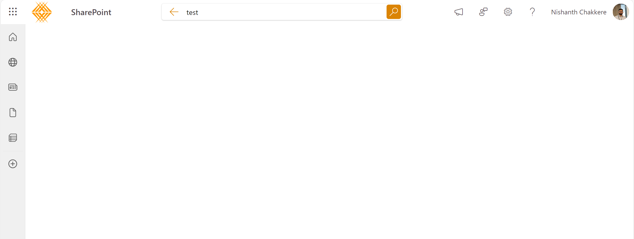

When a search is made at the site level, it works as expected and brings up the results. But in the breadcrumb of the search results, clicking on the hub site ("Test Communication Site" in the image below) returns a blank page. Refreshing the page does not load the results. However, clicking on "Organization" works as expected.

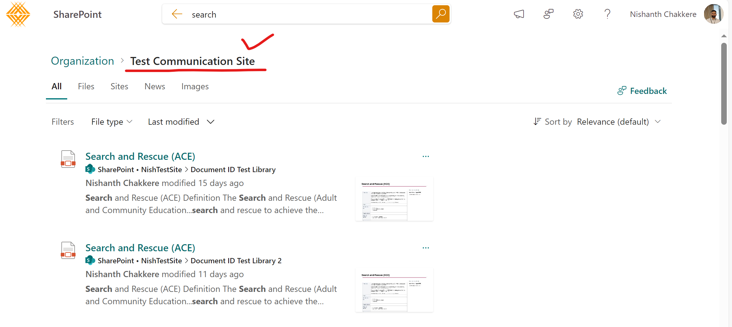

Doing a search directly from the hub site works as expected:

    Because I have some doubts about the breadcrumbs you are searching for. If I do search in hub site, the breadcrumbs will only be Organization>hub site. If I do search in an associated site, the breadcrumbs will only be Organization>associated site. I won't have a hub site in the middle.
    Also, we don't think it's a search problem (because you should get a hint that there are no results instead of a blank page), and it's probably because when you revert to the hub site, the link to the page is broken. This is most likely a problem with the design of SharePoint. We recommend that you report on this issue.

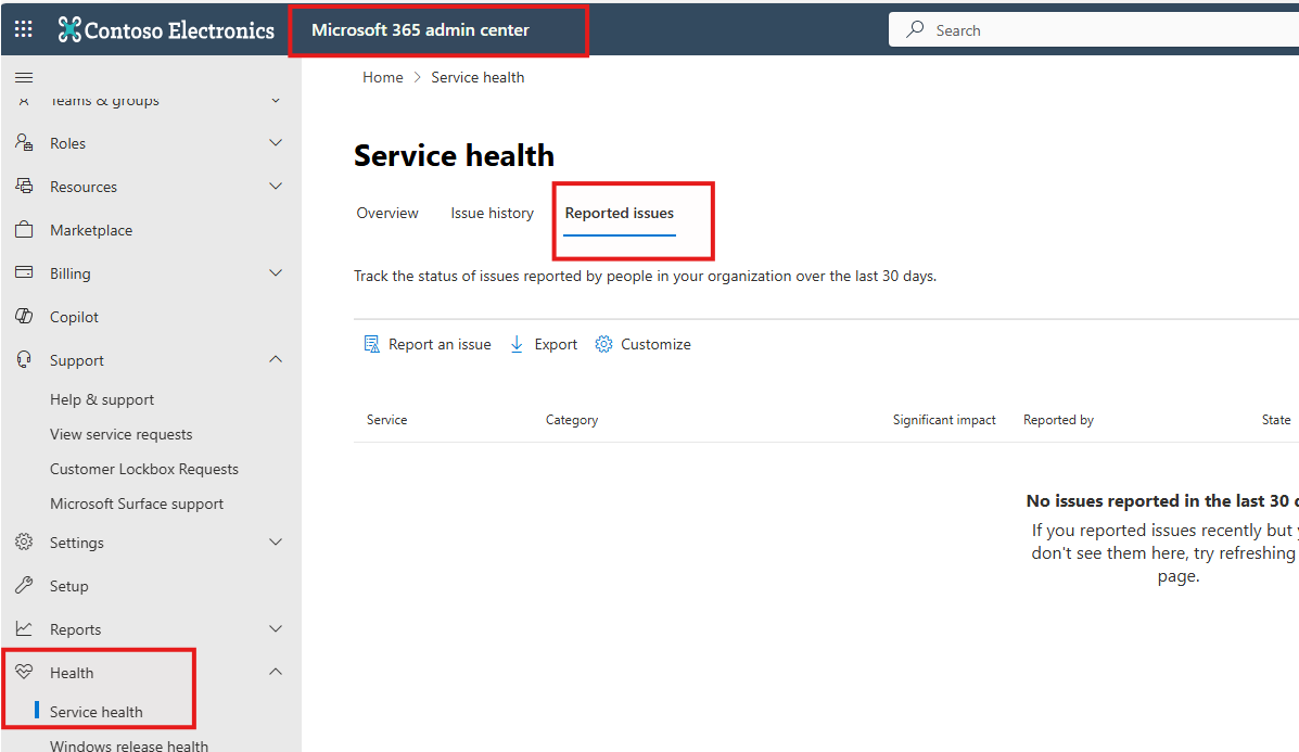

    Please go to M365 admin center >Health >Health Service >Reported issue.
    If this issue doesn't affect you very much, we recommend that you don't fall back to the hub site when searching. If it's important, you can also open a ticket for it.
