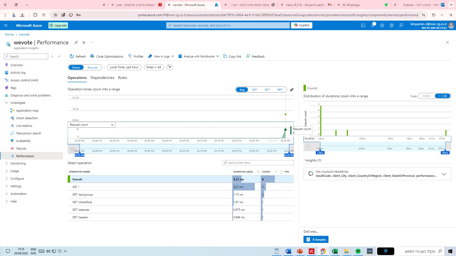

I uploaded Node.js and HTML software, I defined an environment variable, it was local and I uploaded it to azure including a connection to the db.
Actually I can't get data to the browser even though I get a message that it is connected, can someone help give me some recommendations, for several days I can't find a solution.
I get such messages in the console:
Failed to load resource: the server responded with a status of 404 (Not Found)
https://wevote-b8eqa2gwbubcbwf0.canadacentral-01.azurewebsites.net/api/groups
WhatsApp Image 2024-09-29 at 15.36.24

  1. בנימין זיידנר 20 Reputation points
    2024-09-29T14:09:35.9+00:00
    Thanks for the answer, I'll just clarify about the process again, it worked great when I run it on my computer with visual code, after I saw that everything is correct, that is, the sql is updated, returns answers, the forms are updated, I uploaded it to the azure environment, in fact I see the application but the data does not Keep me updated.
    This is the main page, but I expect to receive data, I do not receive data.
