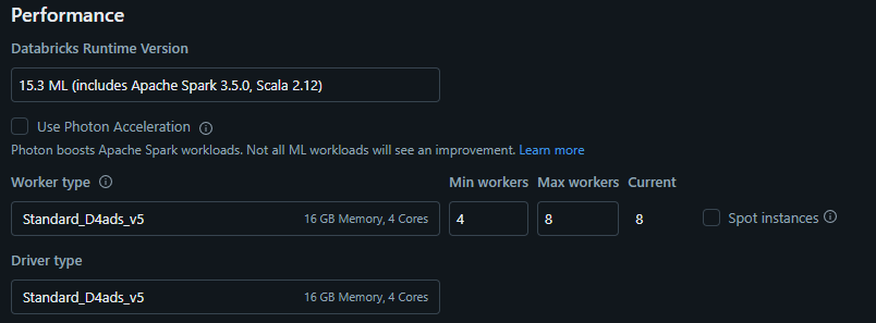

PurchaseOrder : OPTIMIZE PurchaseOrder ZORDER BY (PO_NO)What would be the best way to optmize this join? I am using the below cluster configuration.

    Cluster configuration: Make sure that your cluster is properly configured for the size of your data and the complexity of your queries. You can try increasing the number of worker nodes or using a more powerful instance type to improve performance.
