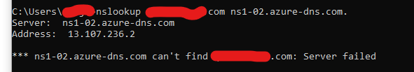

Then I was trying to make email work , so to cleanup some record I deleted the DNS zone service and readded then added the A record again , but now I cant access the website as the domain is not really linked to IP and I get DNS_PROBE_FINISHED_NXDOMAIN in brwoser
when I ping my domain the ping cannot resolve the domain to ip
I waited two days , but nothing changed.
I give ttl 5 minutes but no diffrent.

    First, this is happening because you deleted your Azure DNS Zone. Deleting the DNS Zone breaks DNS resolution. Creating a new zone didn't fix it, because the new zone wasn't placed on the same Azure DNS servers.
