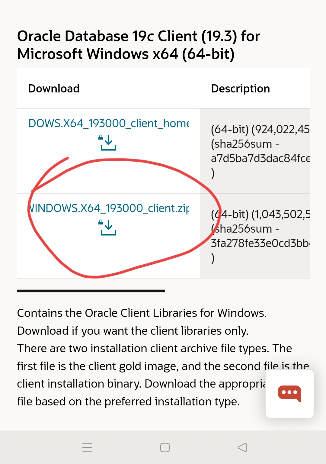

I am working on the Oracle 19c client app. I’ve tried packaging it with both batch and PowerShell scripts, and it’s working manually as well as through SCCM, but when deploying through Intune, it’s giving an error. Could you help me with any modifications needed in the script? I’m not sure if the deployment mechanisms differ between Intune and SCCM. Could you please test my script in your test environment through Intune?
App download link
https://www.oracle.com/database/technologies/oracle19c-windows-downloads.html
1000106660
