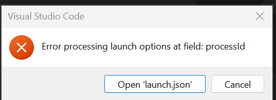

When I am trying to debug the my Azure Function it is ending up in the error. Please image

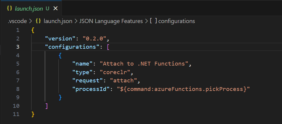

Using the below launch.json configuration
Kindly help me with the solution.
