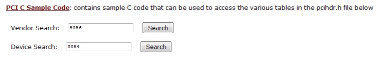

http://pcidatabase.com/
and from what you see in Device Manager enter your VENdor and DEVice information from the network Controller, then click Search:

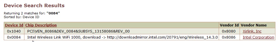

You can see that that device is most likely an Intel wireless device:

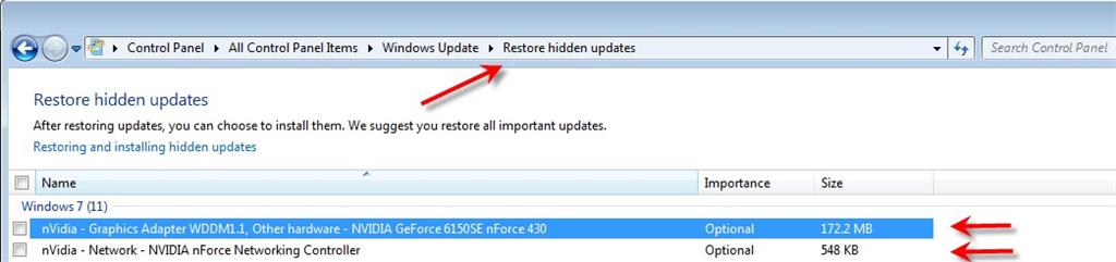

Here you can see where I have chosen not to install and then hidden Windows Updates for an NVIDIA video card since I know they are probably not right and I know I should only get NVIDIA drivers right from the NVIDIA WWW site.
Here you can see the updates that were offered but I did not install them and hid them do I don't see them again:
