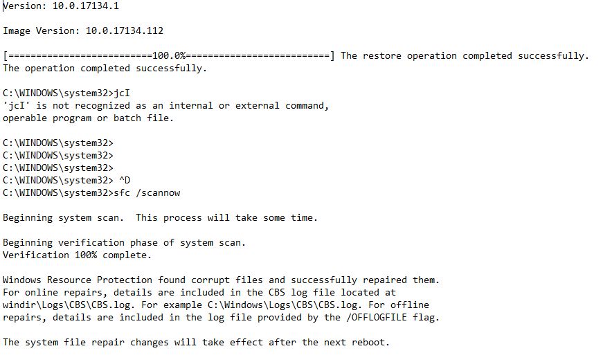

    2018-06-28T02:36:02+00:00
    Hello Charlie,
    Everything went as planned and the hard drive was fixed. I continue to have some performance issues and nothing really changes. However, I went to troubleshoot my device hardware through the windows settings and it said I just had to update some drivers and restart the computer. The first time I did it with a restart it didn't work. Then I did a shutdown and turned it back on and the laptop seems to be running at where it was 3 days ago. I might be experiencing some minor issues still. One thing I did notice however is recently my AC adapter has been shorting out over the past 2-3 weeks and not working properly so I have to buy a new one since the laptop is getting the charge it needs. When I was having the performance issues my laptop was at 94% on the home screen and when the charger started to work again after I came back to the computer later the laptop was running normally again (Note- laptop was at 100% and charging after the charger started to work again.). I also pressed my F2 button upon boot to enter the settings of the laptop from the BIOS I can't recall the name at the moment and checked the power supply and it was at 81% different from the home screen most likely just an error. Anywho, I noticed my battery is exhausted and doesn't hold a long charge anymore and the AC adapter will fully break anytime soon. I will run the system diagnostics upon the boot later and inform you on what it says. I will leave you a TXT file of the logs from this morning after I woke up and the computer was done running the second command you provided me with.
    System log TXT file (JPEG thought you could upload files to)
    Thanks, for all of the help!
    Shane
    2018-06-28T10:30:22+00:00
    Thank you for such a detailed response. It really is appreciated. Also, great work on diagnosing the battery and the power supply. Just like anything else... they have a shelf life. Replacing them will help.
    Saw the TXT file, and i’m Happy it found and repaired some corrupt files. Let me know how you make out with the system diag.
    You’re very welcome, and I’ll be here!
