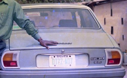

With this input or any other input which I have tried.
11104-035-Cropped - 20

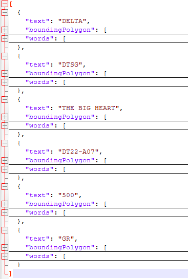

However, if a function app is used as a proxy to call the imageAnalysisClient. The results are different, and I have summarized the response below.
output-01
Is this a known bug which will be fixed or is there an extra parameter to be sent in the request.

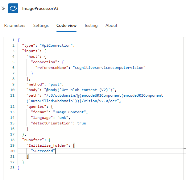

Below is the setup for the action.
config

    It really does seem like the issue lies in how the built-in OCR to JSON actions are implemented within Logic Apps. I’ve run into the same behavior — calling the Image Analysis API directly via an HTTP request works just fine and returns valid OCR results. But when using the official V1 or V3 OCR to JSON actions, the output is either empty or completely invalid.
    At this point, the more reliable workaround might be to bypass the built-in actions altogether and call the REST API directly using an HTTP action or route the request through an Azure Function as a proxy. It’s a bit more setup, but at least you get consistent results.
