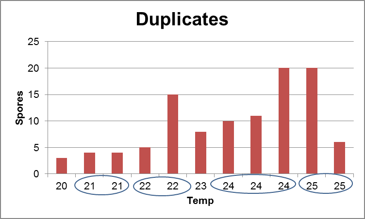

I am trying to make histograms of air particulate concentration (y-axis) and weather data (x-axis).  There are many instances where the value of weather data is repeated on different occasions. Rather than culminating all the spores that occur at a specific weather value (giving one bar per weather value) the column chart makes multiple bars (a new bar for every instance of a certain weather value). I have made an example of what I am getting:

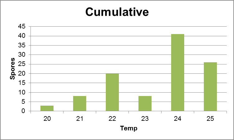

I want to have one bar per weather value (see below), not duplicates for every instance of a value. Is there a way to do this with out manually having to go through and sum everything? The data set is very large. Any help would be appreciated :)
    2016-02-01T21:10:39+00:00
    The Histogram tool is not appropriate for your data. I use the term "histogram" to refer to a column chart of a frequency distribution, and the Excel Histogram tool requires raw data as input. Your data is already partially grouped, and you seem to want a method for grouping the data further so that you can create a Column chart like the "Cumulative" chart shown in your original post. You mentioned that the data set is very large, so I'm reluctant to propose a solution for your example data, because the solution may not be appropriate for your larger data set. A solution for grouping could use Data > Filter or Insert > PivotTable or worksheet formulas like SUMIF or SUMIFS.

    2016-02-01T18:23:49+00:00
    Hi Sherri
    I guess the hidden decimals are responsible for what visually is a repetition but in fact they are different values. I have the following suggestions:
    1. If you care for decimal places, then go to axis options and under Number format increase the decimal place for x-axis
    2. If you do not care for decimal places, then add one column each for Temp & Spores and add a rounding formula to round the figures to nearest whole no. Then base your histogram on the rounded nos.
    Hope this helps
    Cheers
    Khalid Suddle
    2016-02-01T18:43:30+00:00
    Hi Khalid,
    Thank you for your suggestions! However, I do not think this is my problem. The axis are formatted in a general format, and (in the actual data set) the labels are displayed to 1 decimal.  It is definitely a repeating value, not different values with hidden decimals. Even if I change the format of the axis labels, it does not fix the problem.
    The closest I have come to getting it to kind of work, is using a scatter XY plot. This groups the data how I want, but I need it presented as columns rather than markers.
    Cheers,
    Sherri

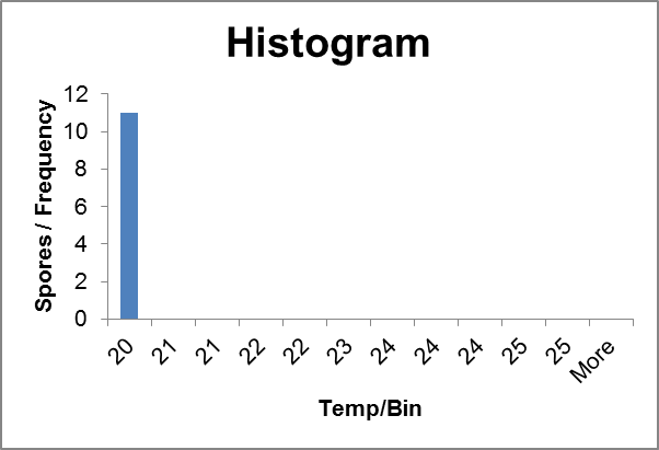

    2016-02-01T20:19:35+00:00
    Hi Mike,
    Thank you! I did not know there was a histogram function in Excel. I was simply making a column graph of my data. I have now installed the Data Analysis ToolPak and have tried to make a histogram of the same sample data I used previously. It lists the categories on the x-axis properly, but it only gives one bar.
    I am not sure why, I selected the cells under "spores" for the "input range" and the cells under "temp" for the "bin range"...what am I doing wrong? I tried to use the Excel help topic, but they were...unhelpful.
    Thanks,
    Sherri
    Data Histogram Data
    Temp Spores Bin Frequency
    20 3 20 11
    21 4 21 0
    21 4 21 0
    22 5 22 0
    22 15 22 0
    23 8 23 0
    24 10 24 0
    24 11 24 0
    24 20 24 0
    25 20 25 0
    25 6 25 0
    More 0
