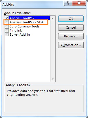

  3. Vijay A. Verma 104.7K Reputation points Volunteer Moderator
    2015-09-29T17:56:41+00:00
    I was talking about "Analysis Toolpack - VBA" not "Analysis Toolpack"..Both should be active..
    Can you post the screenshot of your active add-ins?

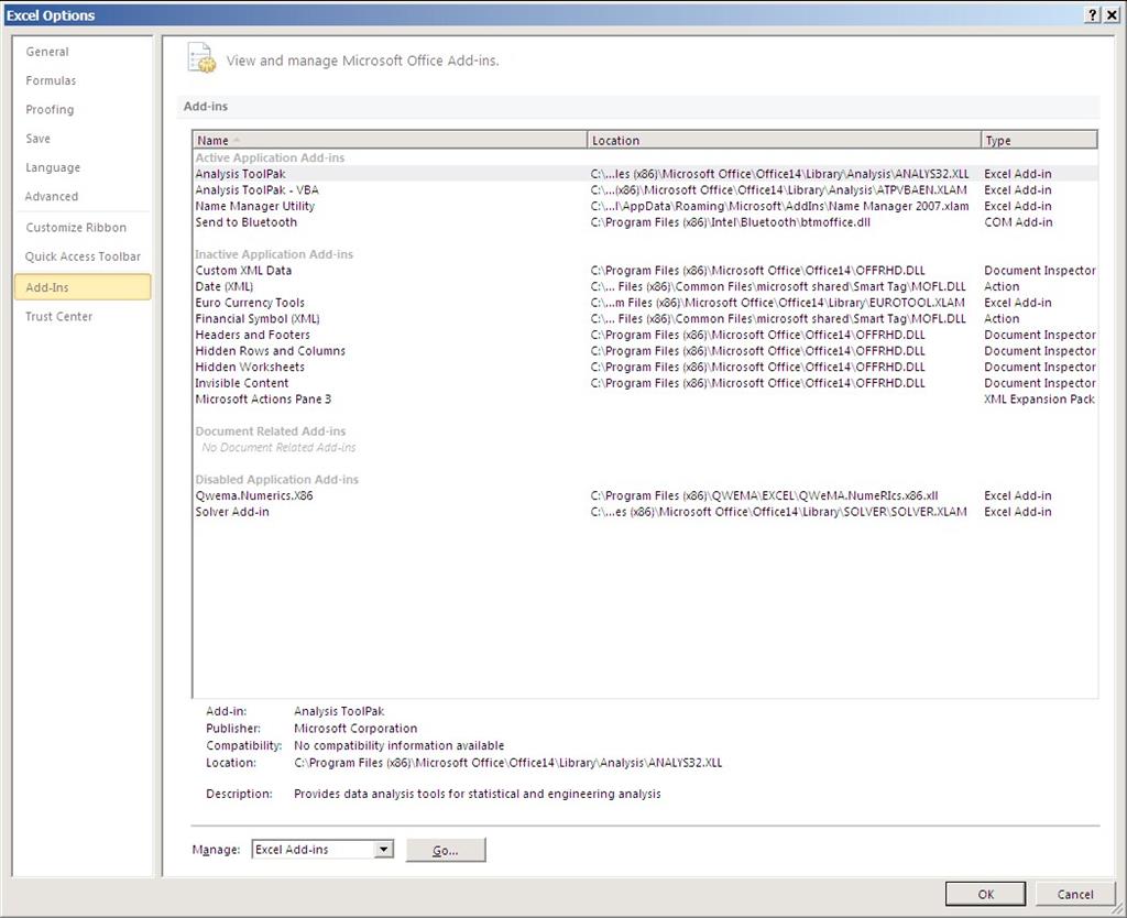

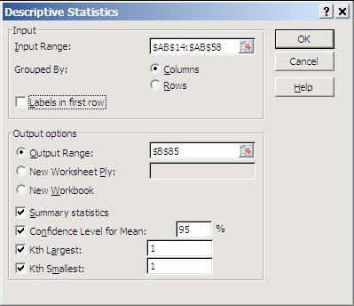

    2015-09-29T23:32:23+00:00
    Hello Mr. Verma,
    Thank you for your continuing support.
    Here is the screenshot you requested as well as an image of the Descriptive Statistics dialog-box with my inputs.
    I hope this helps,
    Sincerely,
    Al
  5. Vijay A. Verma 104.7K Reputation points Volunteer Moderator
    2015-09-30T10:40:03+00:00
    Try disabling both Add-ins and enabling them again. Restart Excel and try again.
