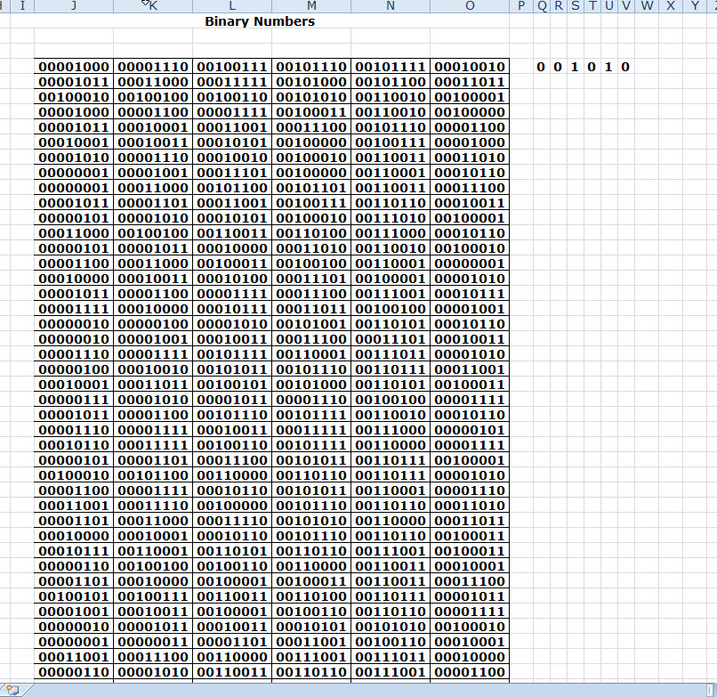

How can I wrote a formula or Macro to convert whole numbers to binary?  This is just 1 example on how it does its math:
Example: Convert 74 to a binary number.
74 / 2 = 37 with a remainder of 0
Binary digits (so far): 0
37 / 2 = 18 with a remainder of 1
Binary digits (so far): 10
18 / 2 = 9 with a remainder of 0
Binary digits (so far): 010
9 / 2 = 4 with a remainder of 1
Binary digits (so far): 1010
4 / 2 = 2 with a remainder of 0
Binary digits (so far): 01010
2 / 2 = 1 with a remainder of 0
Binary digits (so far): 001010
1 / 2 = 0 with a remainder of 1
Binary digits (so far): 1001010
And that brings us down to 0, so the final answer
(74 expressed in binary) is 1001010.

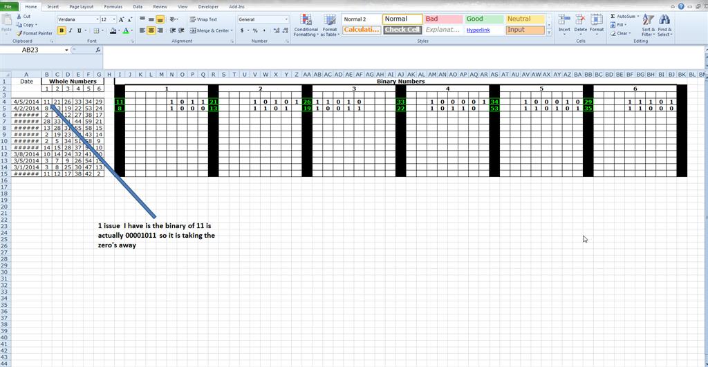

I want to make sure that each 0 or 1 goes in a cell all to itself too.  There are a total of 8 cell potential per number and would like the spreadsheet to look like this below.  If anyone can get me started I will finish it as far as a formula goes.
Thank you so much GURUS!!!!!
If there can be a small change for Hexadecimal (16) and Octal (8) that would be cool but if not that is okay too.  beggars can not be choosy  lol  again THANK YOU!!!!

    I placed this formula in a cell and changed it to meet my criteria and I do not seem to understand how it can work? if we take the first column it has 00001000 and when I place the formula in and drag it only gives me 001010 which is not even close
    This is what I have in  Q:4     =MID(J$4,COLUMN(A1),1)  What am I doing wrong?
