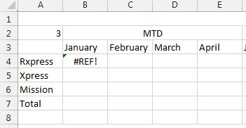

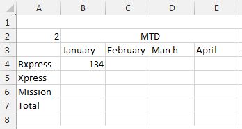

I am attempting to create a table that will reflect a sum that is calculated from a set number of business days. The data is pulled from an outside source worksheet. When the source worksheet is open, everything seems to work fine. When the source document is closed, the formula works for only the first two "business days" I specify. After that, I get a #REF! error.
Here is the formula I am entering into the display document:
=SUM('C:\Folder[Sourcefile.xlsx]Sheet1'!F4:INDEX('C:\Folder[Sourcefile.xlsx]Sheet1'!F4:F28,A2,1))

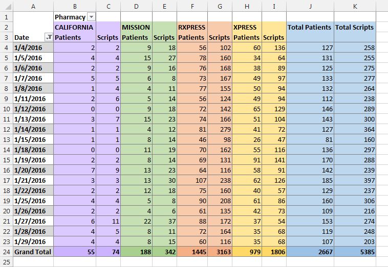

Source File:
Example where the formula reflects the correct result:
Example where formula gives me #REF! error:
So, I am trying to produce a sum in the display document that reflects the month-to-date total on a certain day. For instance, on the second business day (I enter 2 in cell A2 of display document, to indicate how many rows to sum from the start cell on the source document, F4), I get the correct sum of 134 (which is F4+F5). However, when I enter 3 or higher in cell A2, I get the error.
What can I do to fix this?
