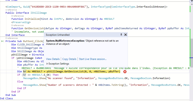

  1. Castorix31 90,686 Reputation points
    2021-08-01T20:07:51.59+00:00
    You should use WIA for scanners ("Windows Image Acquisition Library v2.0" on the COM tab),
    more recent than Twain
    There is also STI
    A test with IStillImage.GetDeviceList to check if there is a scanner connected (it returns 0x80070491 with my scanner when I disconnect it) :
            Dim CLSID_StillImage As New Guid("B323F8E0-2E68-11D0-90EA-00AA0060F86C")
            Dim StillImageType As Type = Type.GetTypeFromCLSID(CLSID_StillImage, True)
            Dim StillImage As Object = Activator.CreateInstance(StillImageType)
            pStillImage = DirectCast(StillImage, IStillImage)
            If (pStillImage IsNot Nothing) Then
                Dim nNbItems As UInteger = 0
                Dim pBuffer As IntPtr = IntPtr.Zero
                '  HRESULT = 0x80070491  Message = Aucune correspondance pour la clé indiquée dans l'index. (Exception de HRESULT : 0x80070491)
                Dim hr As HRESULT = pStillImage.GetDeviceList(0, 0, nNbItems, pBuffer)
                If (hr <> HRESULT.S_OK) Then
                    MessageBox.Show("No scanner found", "Information", MessageBoxButtons.OK, MessageBoxIcon.Information)
                Else
                    MessageBox.Show("Number of scanners detected : " & nNbItems.ToString(), "Information", MessageBoxButtons.OK, MessageBoxIcon.Information)
                End If
            End If
    Simplified declarations :
        Public Enum HRESULT As Integer
            S_OK = 0
            S_FALSE = 1
            E_NOINTERFACE = &H80004002
            E_NOTIMPL = &H80004001
            E_FAIL = &H80004005
            E_UNEXPECTED = &H8000FFFF
            E_OUTOFMEMORY = &H8007000E
        End Enum
        <ComImport, Guid("641BD880-2DC8-11D0-90EA-00AA0060F86C"), InterfaceType(ComInterfaceType.InterfaceIsIUnknown)>
        Public Interface IStillImage
            Function Initialize(hinst As IntPtr, dwVersion As UInteger) As HRESULT
            <PreserveSig>
            Function GetDeviceList(dwType As UInteger, dwFlags As UInteger, ByRef pdwItemsReturned As UInteger, ByRef ppBuffer As IntPtr) As HRESULT
            ' incomplete, not used...
        End Interface
