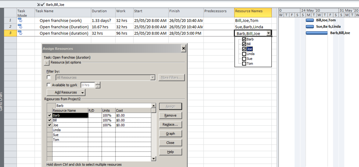

  4. John Project 49,705 Reputation points Volunteer Moderator
    2020-05-08T15:44:31+00:00
    Shailender Bhatia,
    It's not clear if the 32 hours is the estimated duration or the estimated work. It's also not clear why your screen shot shows 40h duration.
    My guess is you didn't use the correct approach when assigning resources. Take a look at this example. It shows three tasks. In the first task the work is set to 32h and in the other two tasks the duration is set at 32h. For tasks 1 and 2 resources were assigned using the Assign Resources window as shown. When using that method Project spreads the total 32h over the 3 assigned resources which effectively makes the duration 1.33 days (or 10.67h) with the Standard calendar. The finish date is 26 May at 10:40 AM. For task 3, the resources are assigned by simply checking the desired resources from the pull down selection box shown in the Resource Names field, or manually entering the resources directly into the Resource Names field. In that case Project assumes each resource will work the full duration (32h) which gives a finish date of May 28 at 5:00 PM.
    Hope this helps.
