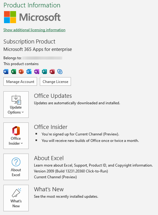

    1. The build and version information of your Excel? (File>Account.) Could you please share a screenshot on the Product information page and help mask your email address to protect your privacy? Like shown below:
