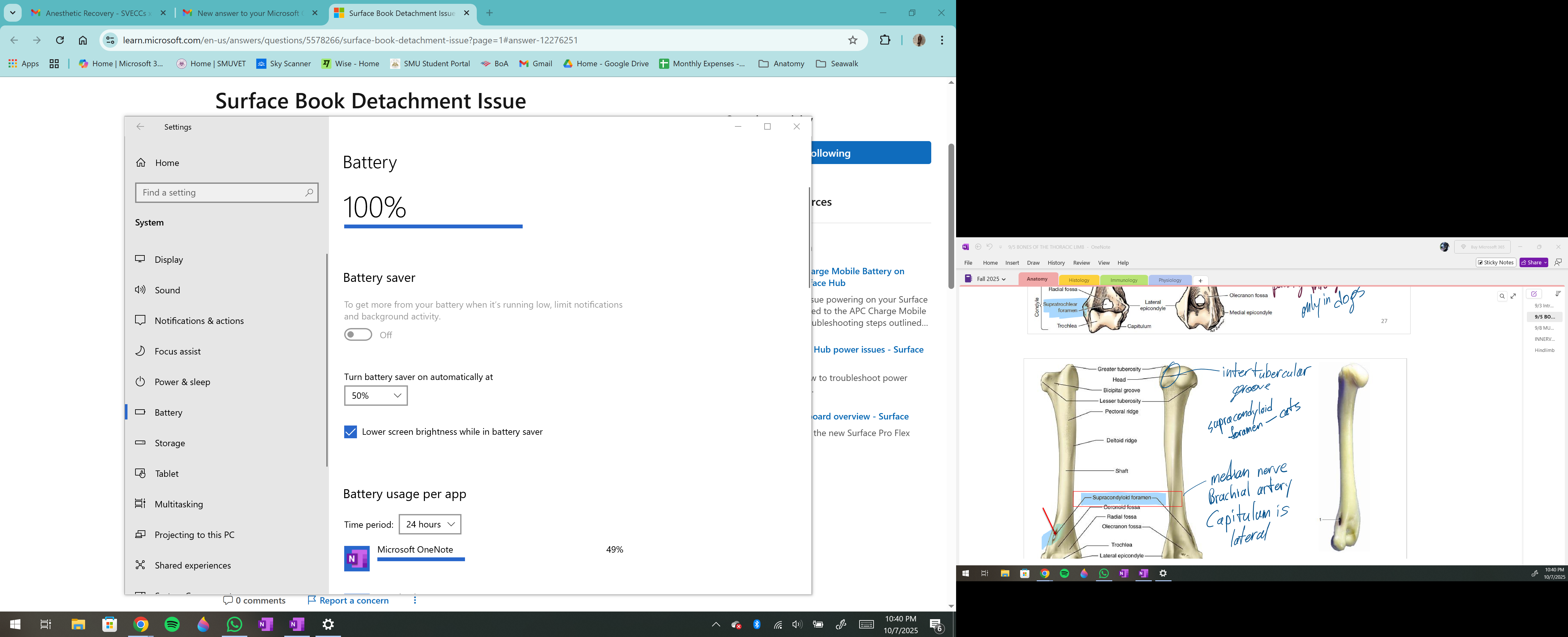

    So I ended the Surface Detach service and no luck. Now rather than saying that the battery is low I will press the key and it stays red for a small amount of time. No notice pops up and then it just remains attached. I tried to look at the battery for the tablet portion but an unsure if I am looking in the right place. I am only seeing one battery percentage.
    PS don't mind my anatomy notes on the other monitor2025-10-07 (4)

    Since you're using a Surface Book 2, one thing to keep in mind is that it actually has two separate batteries, one in the screen it called the “clipboard” and another in the "keyboard base". Sometimes, even if your total battery shows something like 99%, the clipboard battery might still be too low to allow detachment.
    To check this, head over to Settings > System > Battery and look at the battery levels for both the screen and the base. If the clipboard battery is low, try charging your device for a bit and then attempt to detach again.
