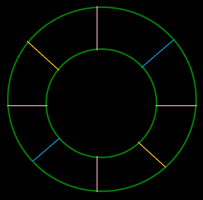

This is pineapple ring I wanted to draw using VB code:
pineapple ring
Imagine the background color is black. Each segment must be same size. The line color can be same for practice purpose. The final image have to output to bitmap file.

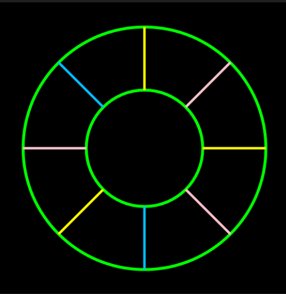

    The code draws onto a Bitmap using a Graphics object:
    • Create a blank bitmap (600×600)
    • Draw two circles (outer + inner) centered on the image
    • Divide the ring into 8 equal slices By drawing 8 lines spaced 45° apart
    • Apply colors to the divider lines Cycling through Yellow → Pink → Blue
    • Save the finished bitmap to the user’s Desktop (pineapple_ring_step6.bmp)
    Angles are calculated in radians:
    angle = i * (Math.PI / 4)
    This guarantees every slice is exactly the same size.
    pineapple_ring.txt
    Output screenshot
    Please let us know if you require any further assistance, we’re happy to help.

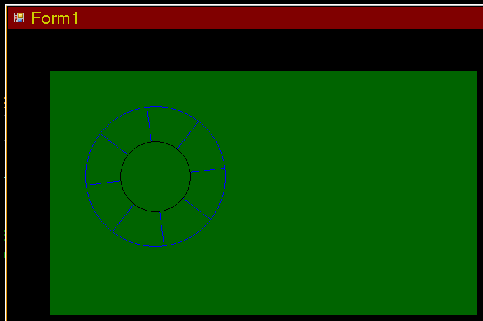

  2. Danny 20 Reputation points
    2025-11-25T16:40:20.23+00:00
    Here is the sample output screenshot:
    pineapple ring 3
    The code I was using:
    `Private Sub PictureBox1_Paint(sender As Object, e As PaintEventArgs) Handles PictureBox1.Paint`
    'NOTE: add PictureBox control to winform and set its background color to darkgreen
    'PictureBox1.BackColor = Color.DarkGreen
    Dim x_value As Int32
    Dim y_value As Int32
    x_value = 50
    y_value = 50
    Dim x_value_b As Int32
    Dim y_value_b As Int32
    x_value_b = 100
    y_value_b = 100
    Dim pieBounds As New Rectangle(x_value, y_value, 200, 200)
    ' Define the start angle and sweep angle in degrees
    Dim startAngle As Single = 0
    Dim sweepAngle As Single = 360
    Dim count As Int32
    Dim degree As Single
    Dim pen_a As New Pen(Color.Black) 'this pen is used for drawing the outer ring
    degree = -7 'set the first segment's degree position
    For count = 1 To 8 'divide 360 degree to 8 segments
    degree = degree + 45 'each segment has 45 degree
    pen_a.Dispose() 'destroy previous instance
    pen_a = New Pen(Color.Blue) 'can change color for each segment, if desire
    e.Graphics.DrawPie(pen_a, pieBounds, degree, 45)
    Next
    'now we draw the inner ring
    Dim pieBounds_b As New Rectangle(x_value_b, y_value_b, 100, 100)
    Dim brush_b As New SolidBrush(Color.DarkGreen)
    'draw the circle (fill in color)
    e.Graphics.FillPie(brush_b, pieBounds_b, startAngle, sweepAngle)
    brush_b.Dispose()
    'draw the circle outline
    Dim pen_d As New Pen(Color.Black)
    e.Graphics.DrawEllipse(pen_d, pieBounds_b)
    pen_d.Dispose()
    End Sub
