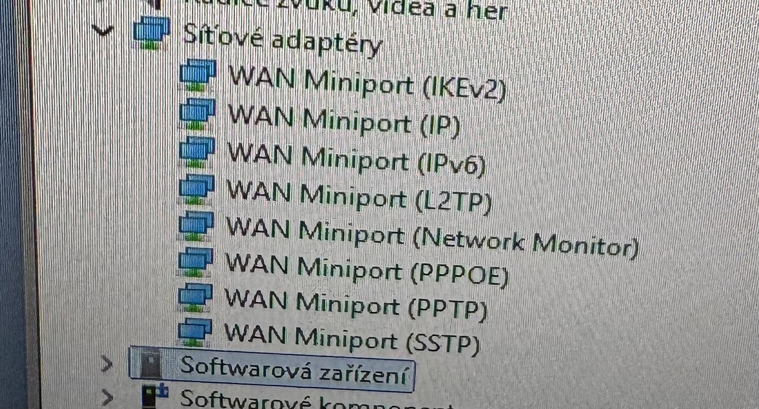

  2. Ivan B 86,690 Reputation points Independent Advisor
    2025-11-27T11:31:28.9+00:00
    Hi ,
    Can you access the device manager in the network and system controllers tab?
    Take a screenshot and post it here.
    Turn off the computer and look at the back, then turn it on and see if the network port flashes to indicate connectivity.
    Thanks
