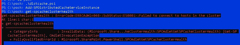

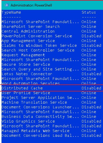

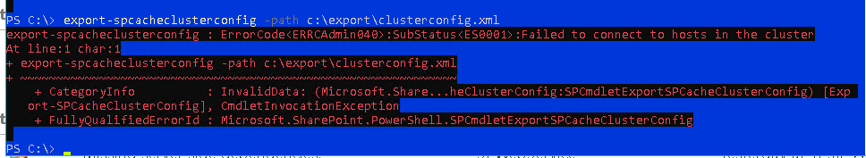

I believe the distributed cache setup in my SharePoint SE farm is hosed. I turn on the SharePoint Caching Service, but it stops almost immediately. I'm trying to troubleshoot the issue using all the advice on Microsoft's Learn site, but No Joy. Even running the 'Export-spcacheclusterconfig' command to try to get at the problem fails, with the error: "Failed to connect to the hosts in the cluster".

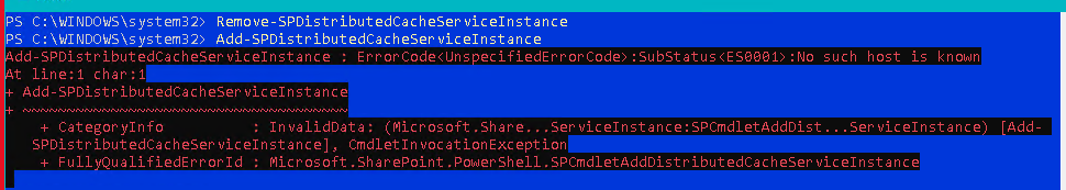

I'm guessing I need to remove and re-create/re-configure the SPDistributedCacheService, but am unable to find the correct procedure to do this.
