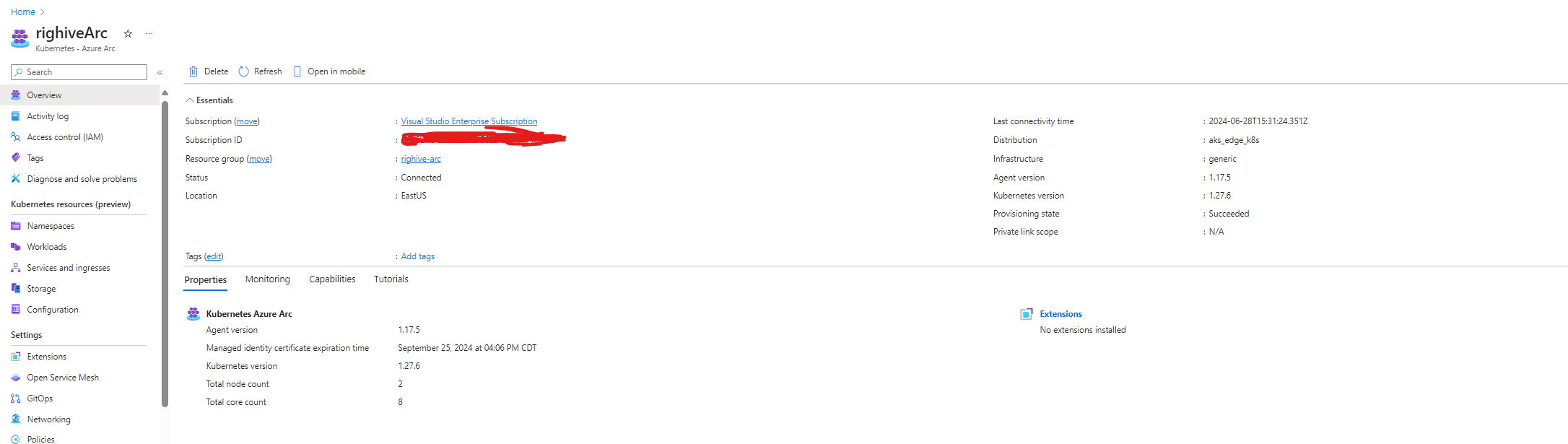

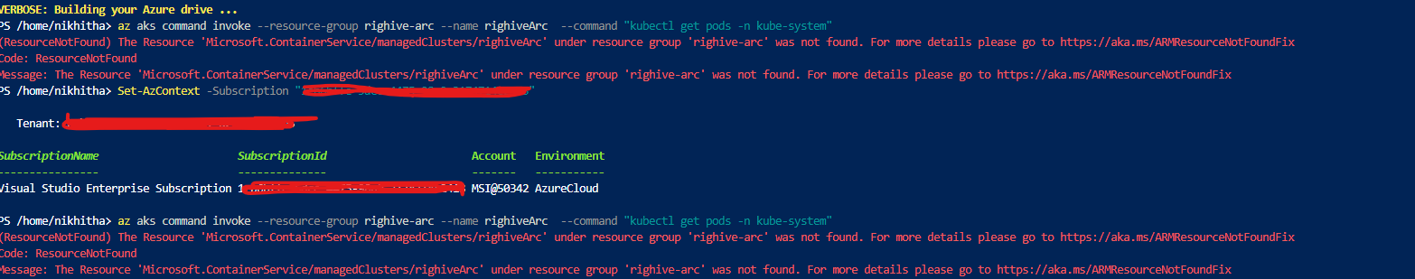

The cluster is connected to Azure Arc and I can see the cluster resources on azure arc. But when I perform any commands to the cluster from Cloudshell, it says cluster not found under the resource group.

This is the error I'm getting while accessing the cluster on Azure Arc.righive
This is my cluster connected to AzureArc.rig2

    I understand that you are getting "ResourcesNotFound" error, despite your cluster connected to AzureArc..
    Solution
    It seems like there might be a configuration issue or a discrepancy between the Azure Arc metadata and the actual cluster state. Though, several things can cause this type of error, I would like you to do the following that will lead us to the right cause and solve the issue.
    1. Confirm that you are using the correct resource group where your Azure Arc-enabled Kubernetes cluster is located. Run the following command in Cloud Shell to list all the resource groups in your subscription:
          `az group list --output table`
      Verify that the resource group containing your cluster is listed.
    2. Ensure that you are using the correct cluster name when executing commands. Use the following command to list all the Azure Arc-enabled Kubernetes clusters in the specified resource group: az connectedk8s list --resource-group <your-resource-group-name> --output table Check if your cluster is listed.
    3. Verify that your Azure CLI context is set to the correct subscription and resource group. Run the following command to view your current context: az account show --output table If needed, switch to the correct context using: az account set --subscription <your-subscription-id>
    4. After confirming the above steps, retry your commands in Cloud Shell. For example, if you're trying to get the nodes of your cluster, use: kubectl get nodes
    If the issue persists, please provide additional details or any error messages you come across to help further.

  2. Nikhitha Chandana Chinthapalli 0 Reputation points
    2024-07-02T04:53:48.43+00:00
    Hi Sina,
    I followed your instructions.
    1. Confirmed that I'm using the correct resource group where your Azure Arc-enabled Kubernetes cluster is located using command "az group list --output table".
    2. Ensured I'm using correct cluster name.
    3. Set current context to my subscription
    After following these steps, the issue still persists.
    Thanks,
    Nikhitha.
