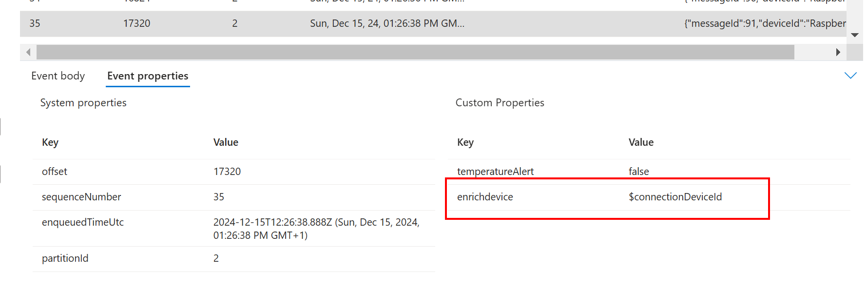

    I tried it myself and the enrichment of putting a system properties failed:

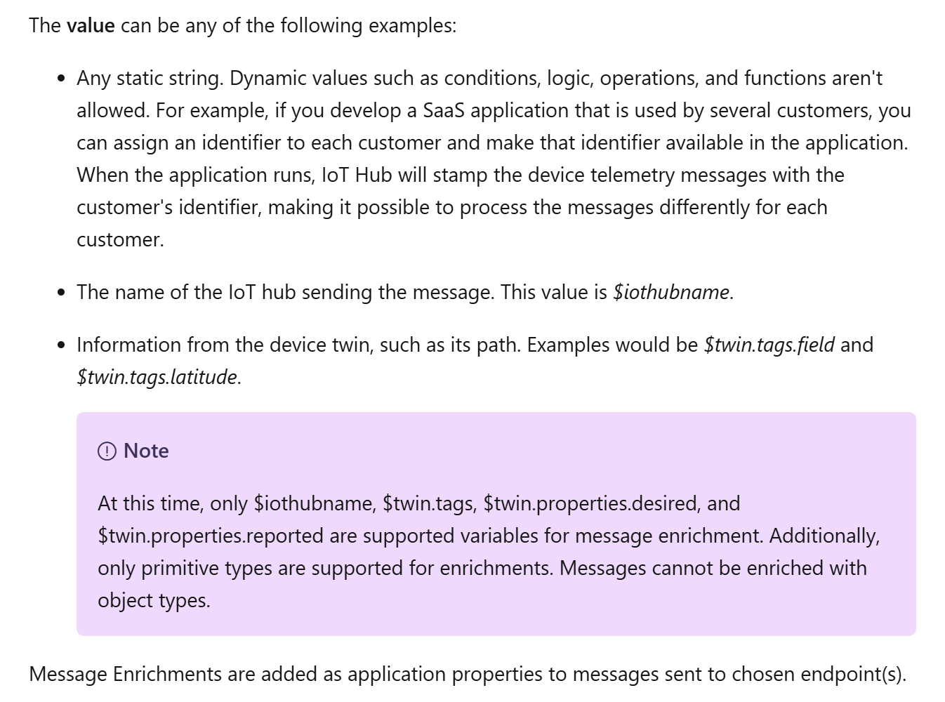

    According to the documentation, adding systemproperties is not supported:
    I also observed the original IoT hub system proerties are not outputted by the eventhub. These seems to 'get lost in translation'.
