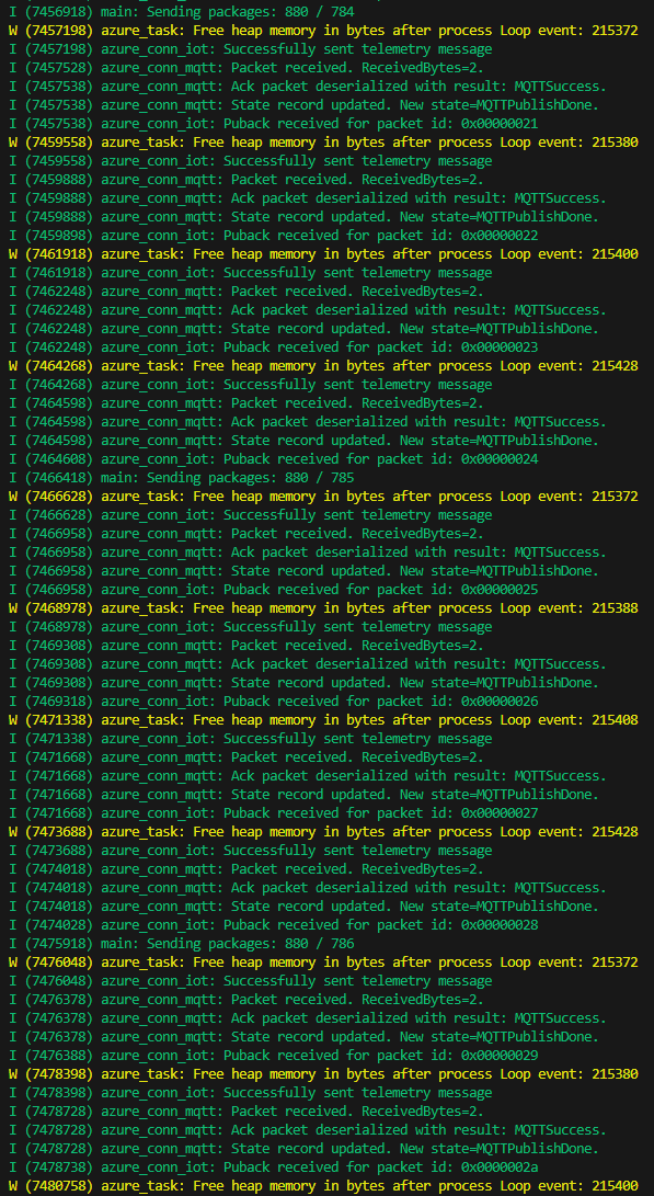

I'm doing endurance testing on the Azure IoT middleware for the FreeRTOS SDK (link). I am thinking of using the library for our application. I've modified the esp32 sample_azure_iot_pnp example for the test. Currently, the endurance test sends 4 packets every 9.5 seconds, repeated 880 times.
When testing - often mid-flow - I get the following error:
I haven't been able to identify the cause of this error or why it occurs. Has anyone experienced this or know how to deal with it? I have not been able to find out what errno 119 corresponds to?
My current workaround is to disconnect and restart the Azure code when the error occurs. When I do that then I leak some memory from the heap:
Have I forgotten to call or close something? Here is the task:

Thanks in advance for any advice!
