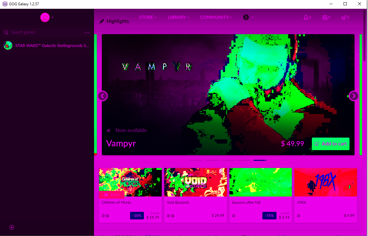

Hardware acceleration doesn't seem to work on my pc for some reason. I am scratching my head on this one. I have scoured the internet and I have yet to find the right solution..  I am running windows 10 pro on a custom built pc with a ryzen 5 2600 currently running stock with a GTX 1070 ti also running stock with 16gb ddr 4 3000 Gskill flare X running at 3200 speed on an Asrock X470 Taichi motherboard.  I currently have a dual monitor set up with a 144hz 2k display and a 1080p 60hz display. Whenever I run a program that uses HWA, it looks pink and digitized which forces me to disable the hwa for that program.  So far, I have had to disable hwa fro Spotify and Chrome.  I have completely uninstalled my display drivers and then reinstalled them. I have tried turning off G-Synch, I have tried changing resolutions and refresh rates.  At first, I thought it was an issue with my monitor because I first noticed the issue when I upgraded my monitor and I spent a couple of hours with Acer tech support with no resolution. But now since I have added a 2nd monitor I no longer believe that to be the case.  I was wondering if anyone else has had this problem and if so what was the fix?  Should I try reinstalling windows?

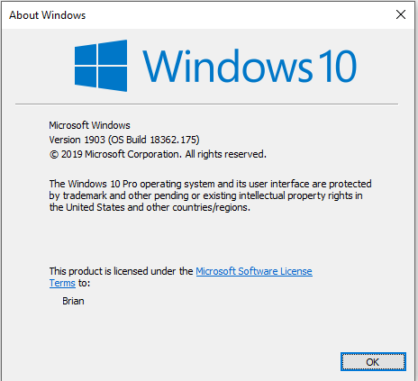

    2019-06-23T23:33:20+00:00
    Version 1903

    2019-06-22T10:12:35+00:00
    It looks like the Vampyre game as some display issues.
    • Have you tried the 'Green Screen Flickering / Black screen'  fix shown in the Steam forums below ?
    (The fixes are about half way down the article)
    https://steamcommunity.com/app/427290/discussions/1/1697174779862251361/
    2019-06-22T08:39:16+00:00
    Thanks Andre,
    I tried all your recommendations, unfortunately I was still not successful in correcting the issue.  I think there may be an issue with the display driver afterall, But I haven't found any posts from Nvidia graphics card users having the same problem.  Oddly, everything works perfectly while gaming.
    Respectfully,
    Brian
