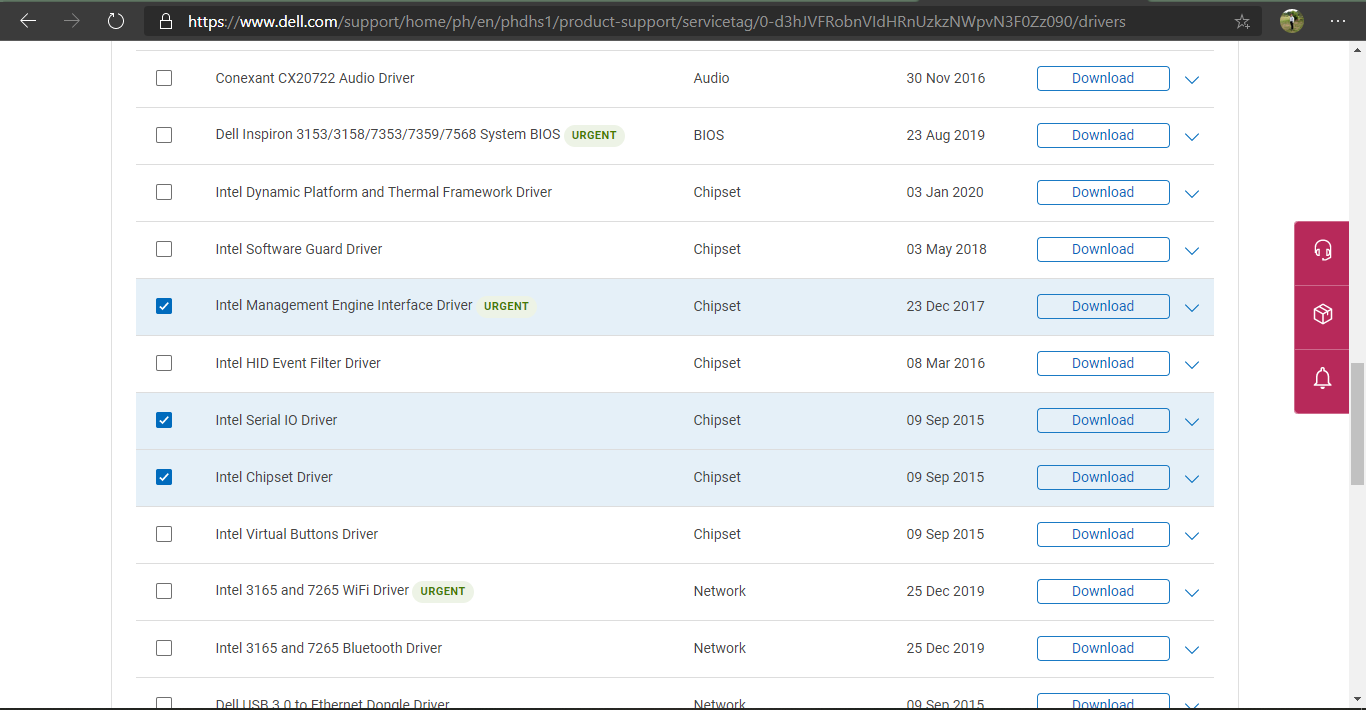

    Please go to: https://www.dell.com/support/home/ph/en/phdhs1/...
    Download and install the following:
    1. Intel Serial IO Driver
    2. Intel Chipset Driver
    3. Intel Management Engine Interface Driver
    If my suggestion did not solve the issue, please reply back so we can try another solution.
