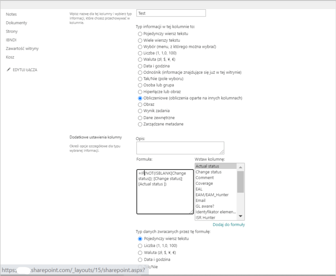

I am trying to create a simple formula for a new column in my SharePoint list.
I was inserting many different forms but it throw the same error each time (and yes, there is a space between 's' and the square bracket in 'Actual status ]')
I tried to find the solution but it seems that noone was able to help yet.
=JEŻELI(NIE(CZY.PUSTA[Change status]); [Change status]; [Actual status ])
=JEŻELI(NIE(CZY.PUSTA[Change status]), [Change status], [Actual status ])
=IF(NOT(ISBLANK[Change status]); [Change status]; [Actual status ])
=IF(NOT(ISBLANK[Change status]), [Change status], [Actual status ])
The error in the last screenshot says "syntax error or the formula is not supported"

    I go through the post carefully. It seems like you are creating formula in a calculated column in a SharePoint list and it throws an error "syntax error or the formula is not supported".
    For this formula you have created:
    When I test it from my side, I can reproduce the same error message as you mentioned. I'm afraid this formula do have syntax error.
    The formula NOT(ISBLANK[Change status]) will return TRUE or FALSE. That means the IF formula will be like
    =IF(TRUE, [Change status], [Actual status] ) or
    =IF(FALSE, [Change status], [Actual status] )
    I'm afraid it's not a correct IF formula. IF formula's syntax is
    IF(logical_test, value_if_true, value_if_false)
    For "logical test", it's the condition you want to test. You will need to clarify the condition, not just put the value "TRUE" or "FALSE".
