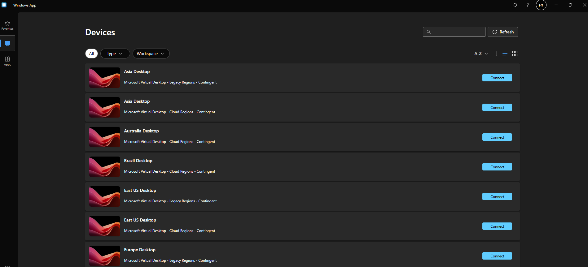

    Please note that VPN connections are NOT considered to be within Corpnet. If you need to access IP restricted data factories remotely, you may be able to route traffic to management.azure.com over your corpnet VPN connection. Keep in mind this can fix ADF access but cause other issues so proceed with caution: Open an administrative command prompt Run 'nslookup management.azure.com ' and make note of the IP address listed Run 'ipconfig' to get your MSFTVPN IP address Add a route rule to force all traffic to management.azure.com via VPN with 'route -p add <<nslookupip>> mask 255.255.255.255 <<Your MSFTVP IPv4 address>>' Test access to Data Factory in an InPrivate window to avoid caching issues If this causes any issues, you can undo this by running 'route -p delete <<nslookupip>>' Alternatively, you can get reliable access to ADF via a Remote Desktop. You can request one here: https://microsoft.sharepoint.com/sites/Security_Tools_Services/SitePages/WindowsVirtualDesktop/CSEO-Windows-Virtual-Desktop-Pilot.aspx
