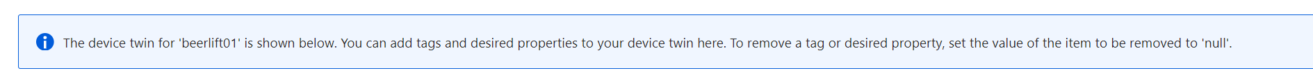

    Look at the portal experience of Azure IoT device twin:
    The Azure portal tells us to remove each item, we cannot remove all desired properties at once:
    set the value of the item to be removed to 'null'.
