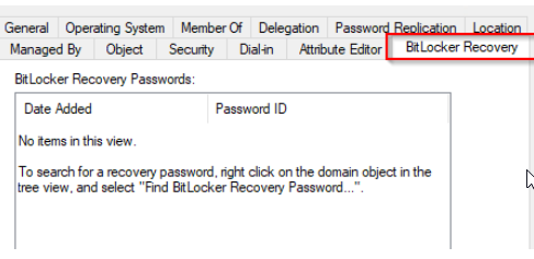

  • The Bitlocker should encrypt my C:\ drive and D:\ drive, but it encrypt only C:\ drive
  • The Bitlocker Recovery KEY does not stored on my DC under Computer -->Properties--->"Bitlocker Recovery".

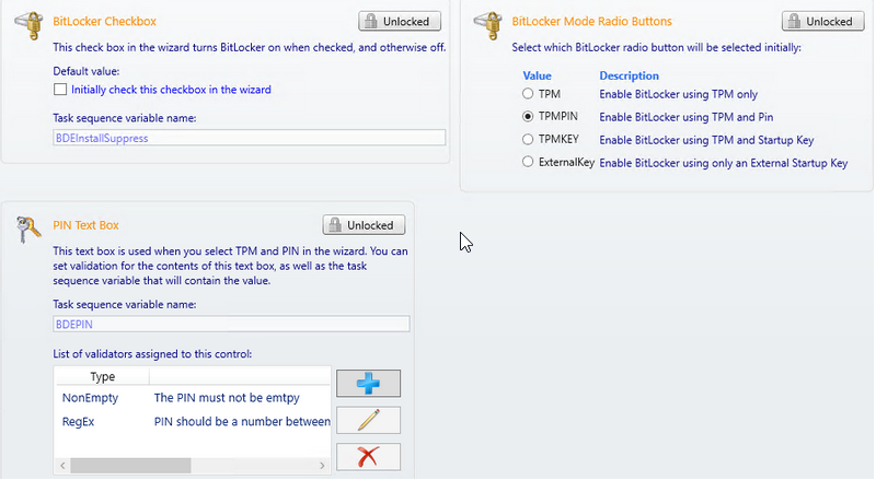

My setting on the UDI Designer
I did check the log file "ZTIBde.log" and "smsts.log" and found the following information:
The task sequencer log is located at C:\WINDOWS\CCM\Logs\SMSTSLog\SMSTS.LOG. For task sequence failures, please consult this log.
System drive is: C:
We are running a OS that supports BitLocker
OSDBitLockerTargetDrive= , OSDBdeTargetDriveLetter= , sOSDBitLockerTargetDrive= C:
About to perform variable rationalization.
BitLocker Mode set to: TPMPIN
Starting search for removable drive
The search for a USB drive failed
BitLocker Startup Key Drive Value set to: C:
BitLocker Create Recovery P@ssword Status: AD
BitLocker Wait For Encryption Status set to: FALSE

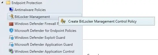

    Are you targeting Windows 10 or Windows 11, and have you tested the affected range?
    I recommend you use the BitLocker Management Control Policy to control the BitLocker.
    Use modern PowerShell scripts instead of VB scripts.
    SCCM MBAM integration
