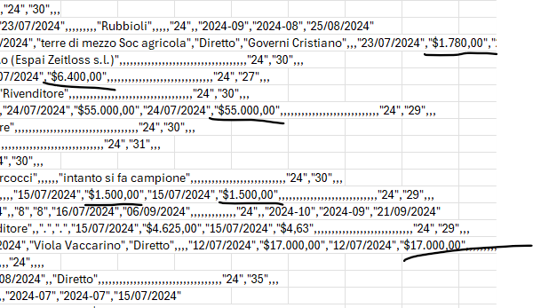

Hello Everybody,
I have a strange problem with a Sharepoint Currency field in a SharePoint List. I want to show the values as currency but this is not possible as shown in the picture attached.
Picture 1
The field is set as currency and all the parameters are ok! The strange thing is that I have created another identical List for Testing purpose and in that Lists I am able to see the same number as Currency value as shown in the second picture attached.
Picture 2
At this point I have checked the international settings of the 2 SharePoint Websites where these 2 Lists are located and they have all things and settings the same. All the parameters seems to be the same.
When I export the values in Excel or CSV from the List the values are stored correctly as currency as I show in Picture 3
Picture 3

  1. Achille Tessitori 5 Reputation points
    2024-07-25T10:17:44.3766667+00:00
    I found the problem
    I formatted the column with black borders like an Excel cell and this formatting is changing the format of the values in the field. If I remove the borders it works fine!!
