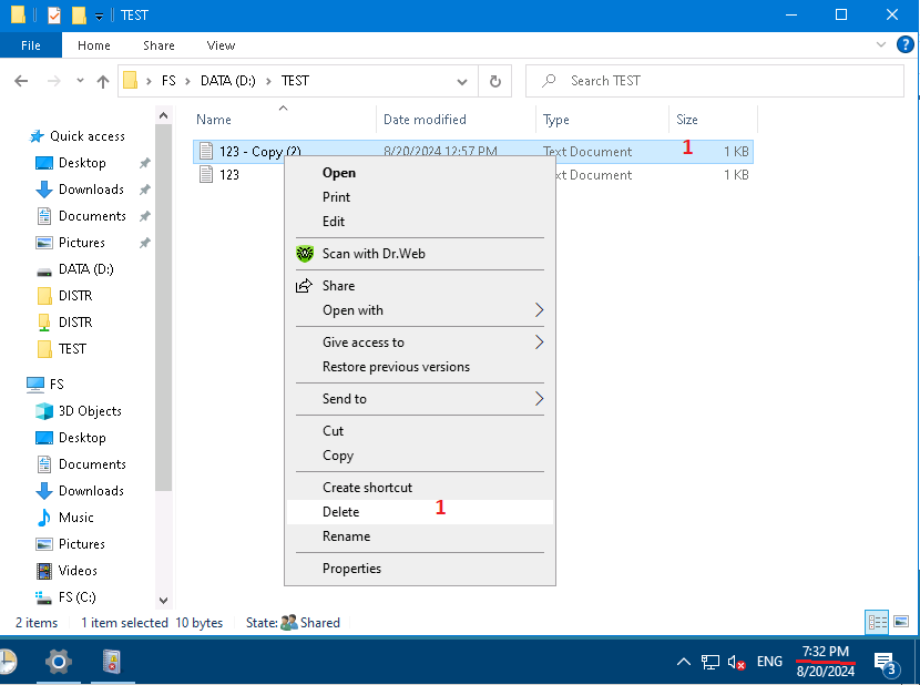

Test 1: I delete the file locally from the D:\Test folder (locally here means "by using the path D:\Test[file to delete]"
02

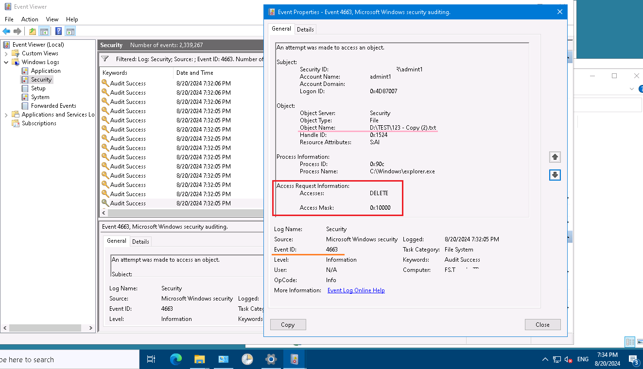

Deleting the file 123-Copy.txt produces the following events (among others) in the Security log:
  1. event 4663 - with Access mask = 0x1000 meaning the object was deleted...03

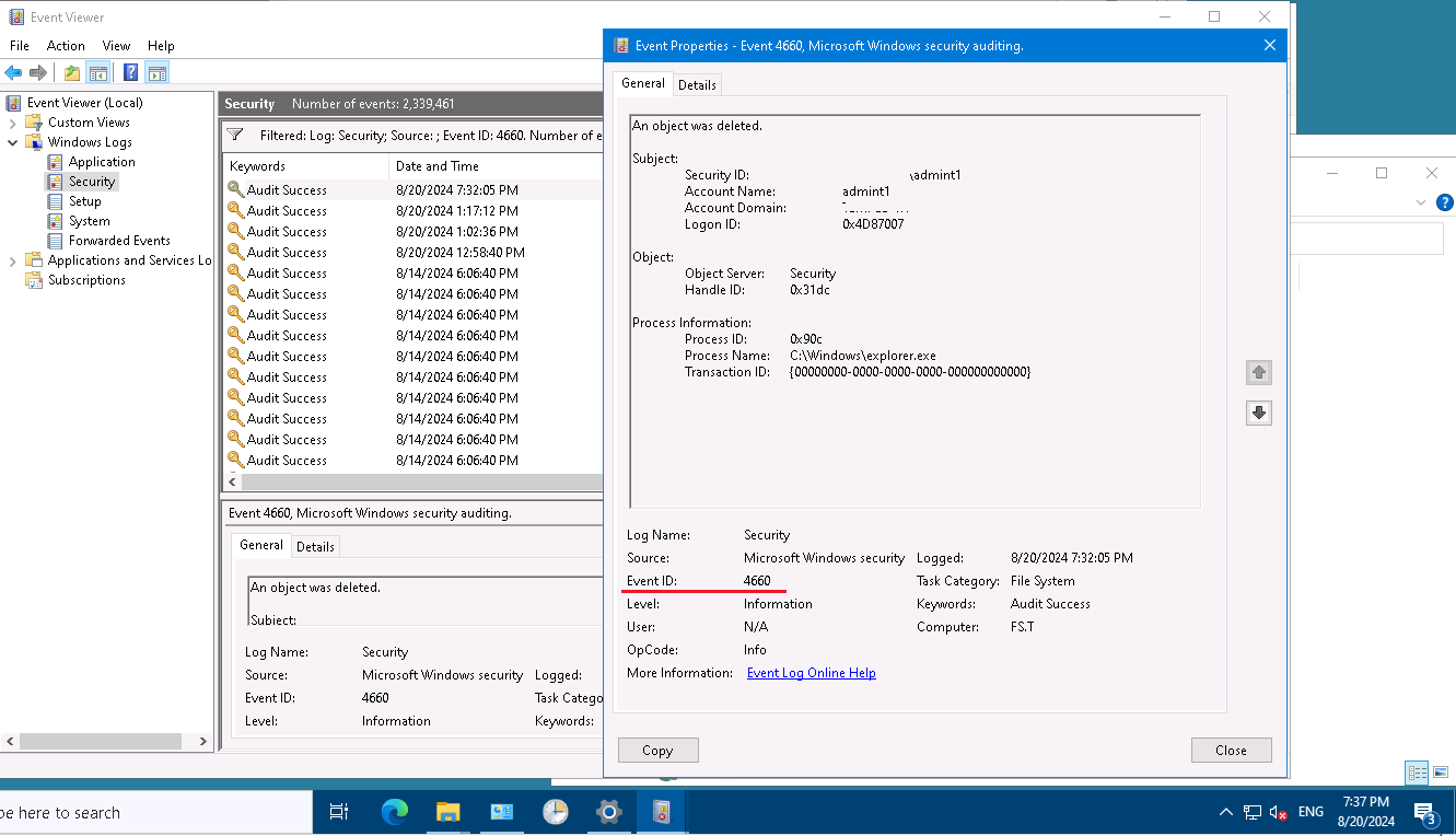

...and
2)event 4660 - Object Deleted:
04
So far so good...exactly as it should work.

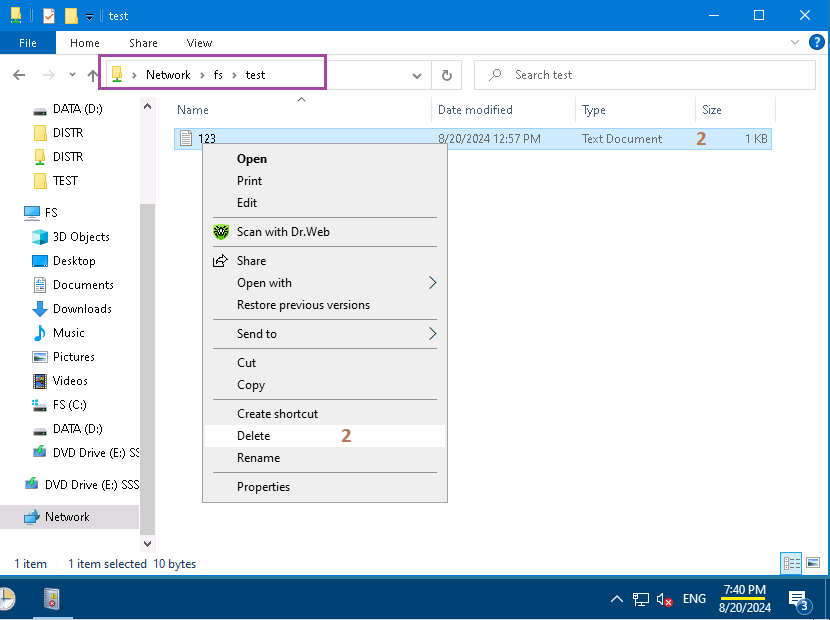

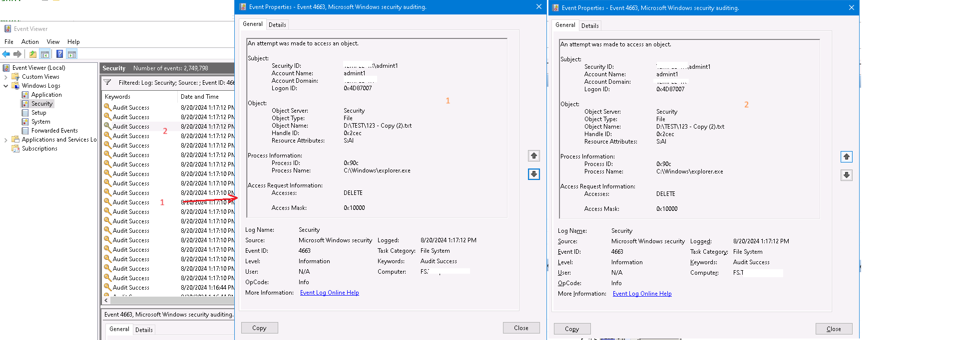

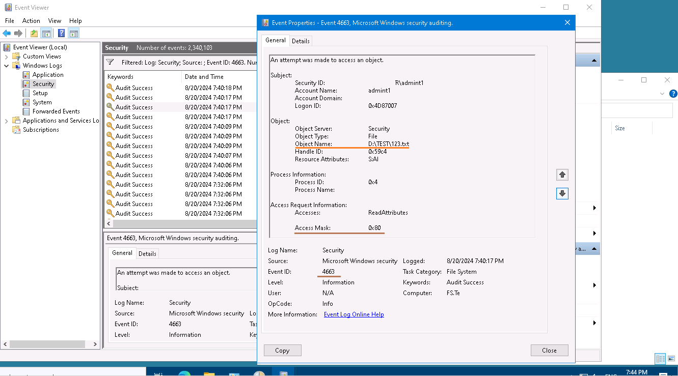

Test 2: I delete the file 123.txt from the file share using the UNC path \fs\Test[file to delete]".
As you know users usually work with their files/folders when they are placed in the servers' shares, not by accessing them locally on the servers' file systems so it's much more important to be able to trace object deletions when those objects are being accessed via file shares.
In this test I'm deleting the 123.txt file from the \fs\Test share while logged on to that same server (fs) - NOT from the client's workstation because the problem does manifest itself even when I'm accessing the file in the same folder, on the same server, but using another method (UNC path):
11
12
13
This time event 4663 does get logged but only with access mask = 0x80 and, of course, there will not be any 4660 even - therefore, this file deletion will be left untracked.

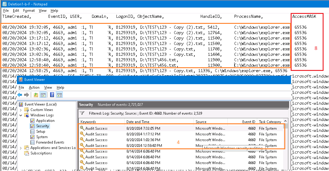

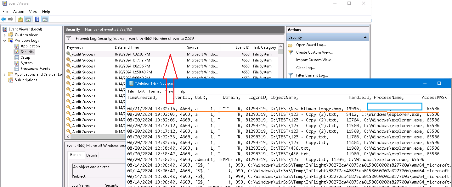

    P.S. I was not strictly correct saying "the problem does manifest itself even when I'm accessing the file in the same folder, on the same server, but using another method (UNC path):" - yes, it does, but not in the same way as when the share is accessed from a user workstation (not from the server itself): I've found out that
    1. deleting a file located in a file share while you are logged on to that server produces neither 4660 event nor 4663 event with access mask =65536 (DELETE) - there will be no traces that a file has been deleted
    2. deleting a file located in a file share from some other computer does not produce any 4660 events but does produce the event 4663 with Access Mask = 65536, for example:
      F3-1
    • I deleted the file (New Bitmap Image.bmp) in the same share - \fs\Test - from another server :
      (you can make sure this was the "network" deletion by looking at the ProcessName field - it must be empty in that case)
      F2
    • it means the number of 4660 events will not be equal to the number of 4663 events with Access mask=65536!
    1. The number of events 4663 with AM=65536 (and - in theory - events 4660) may double on some servers:
      F1
    F3-1
    I've never seen the problems described in 1 and 2 and am sure I can't count on such audit in production environment.
    Now I see these problems (1-2) in Windows Server 2012R2, Windows Server 2019 and Windows Server 2022.
    On Windows Server 2012R2 I've been able to see the two correct events 4660 when the files in the share were deleted from a client workstation - all other attempts (~10) were unsuccessfull (there were no 4660 events but all 4663 events with access mask 65536 were created).
    You can find the scripts that were used to produce the txt-files mentioned in this post here:
    Windows Audit Part 4: Tracing file deletions in MS PowerShell
    Regards,
    Michael

  3. Daisy Zhou 24,666 Reputation points Microsoft Vendor
    2024-08-21T11:39:02.0366667+00:00
    Hello
    Thank you for posting in Q&A forum.
    Based on the information above, I have done a similar test in my lab.
    I have the exact same result as you.
    After I delete the files locally, I can see event ID 4660 and 4663.
    After I deleted the files on one client via UNC path, I can see only event ID 4663.
    Here is the event ID 4663 after I deleted the files via UNC path on one client.
    An attempt was made to access an object.
    Subject:
    Security ID:		A\Administrator2
    Account Name:		Administrator2
    Account Domain:		A
    Logon ID:		0x3BFFB7
    Object:
    Object Server:		Security
    Object Type:		File
    Object Name:		C:\New folder\6.rtf
    Handle ID:		0x1030
    Resource Attributes:	S:AI
    Process Information:
    Process ID:		0x4
    Process Name:
    Access Request Information:
    Accesses:		ReadAttributes
    Access Mask:		0x80
    You can try to not give the normal user permissions to delete file or sub folder on the root folder.
    I hope the information above is helpful.
