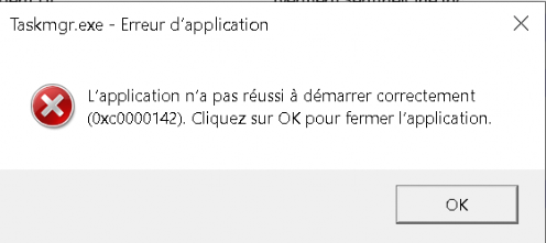

I am experiencing an issue where applications are only able to launch successfully when they are open in Safe Mode. In normal mode, the apps either fail to open or encounter errors. Something in normal mode is preventing the apps from functioning correctly.

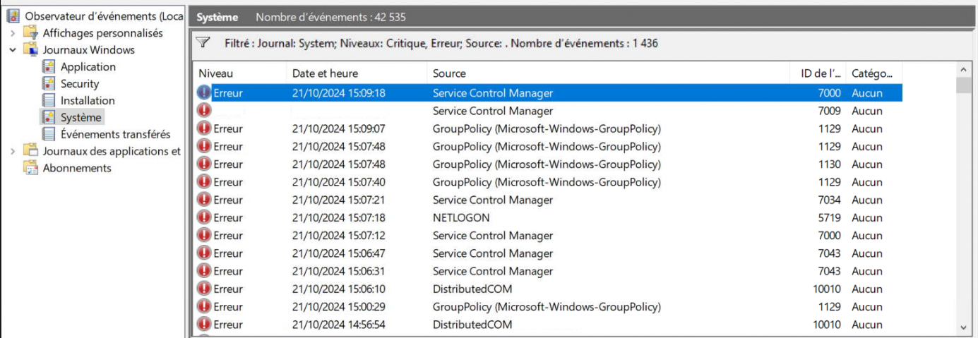

    It sounds like there might be a conflict with a driver, service, or startup program that's causing your applications to fail in normal mode. Here are some steps you can take to troubleshoot:
    1. Perform a Clean Boot: This helps identify if a background program or service is causing the issue
    2. Check for Driver Issues: Outdated or corrupted drivers can cause applications to fail. Update your drivers
    3. Run System File Checker (SFC) and DISM: These tools can repair corrupted system files:
    sfc /scannow
    DISM /Online /Cleanup-Image /RestoreHealth
    1. Check Event Viewer: Look for any error messages that might give you more information about what's causing the issue.
    2. Uninstall Recently Installed Software: If the issue started after installing new software, try uninstalling it to see if that resolves the problem.
