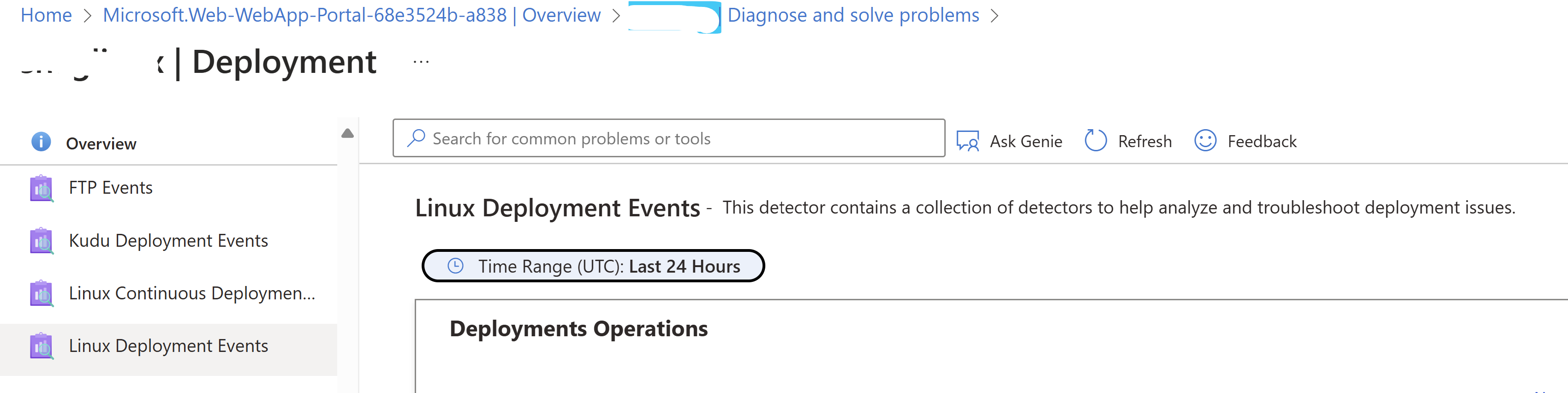

    Suggest you to enable App Service Logs Also- go to diagnose and solve problems from Azure Portal and look for Linux deployment events-
    1. The build that is causing your deployment to fail.
