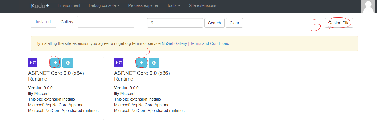

    You can try to verify it by using another region. We can also try to solve this problem by adding additional extensions.

    I tried both suggestions, but App Service Build Service still failed to build .NET 9 project. I think the problem is because a generated CI script is relying on MSBuild but there is no MSBuild 17.12 installed in the app service.
