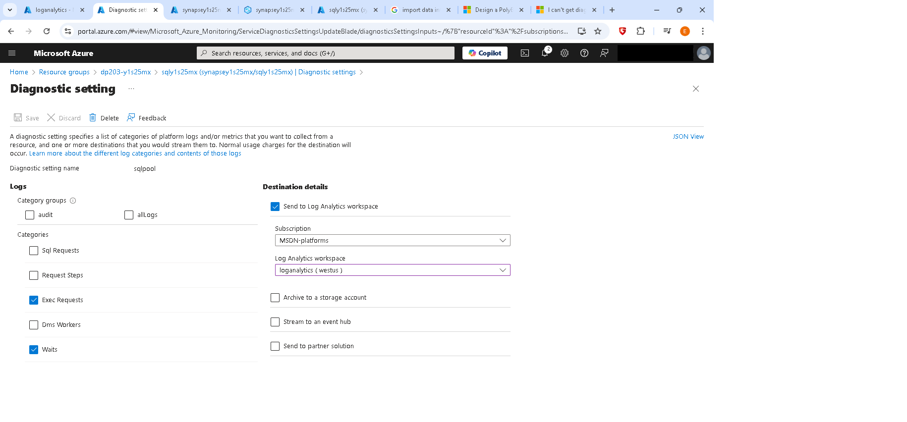

I want to see the exec requests and waits on a dedicated pool.
So I created a log analytics workspace in the same workspace as the sql pool and I went to the dedicated sql pool and in the Diagnostics Settings option I created a new one for the logs exec requests and waits.
Then I connected to the database by using SSMS and ran a few queries.

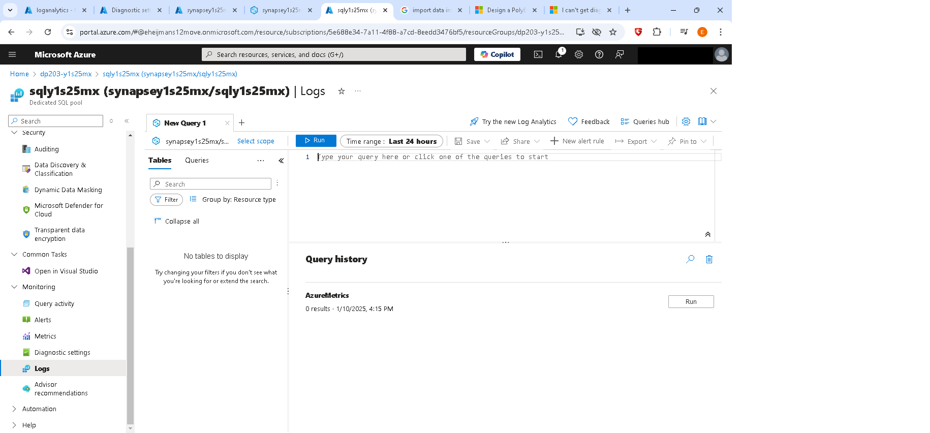

But I can nowhere find the results. I don't see tables under Logs in the Log Analytics Workspace. I don't see them in the logs of the Synapse Workspace. There aren't any tables under the option Logs of the dedicated SQL Pool. And when I go to the Synapse Studio and look under Monitor to SQL Requests, that is empty too.
What am I doing wrong?

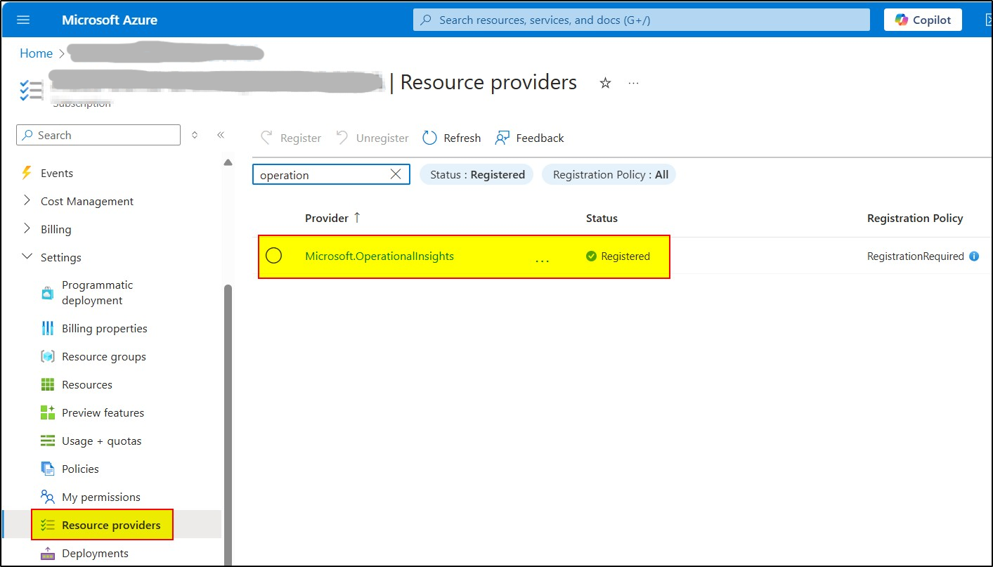

    Resource Provider Registration - This is often overlooked. Ensure the Microsoft.Synapse resource provider is registered in your Azure subscription. You can check this in the Azure portal by going to Subscriptions -> Your Subscription -> Resource providers. Search for Microsoft.Synapse. If the status is NotRegistered, click Register. This is crucial for proper integration.
    Do the same for Microsoft.OperationalInsights (needed for Log Analytics).
    User's image User's image

    Querying Logs - That's the problem: there aren't any.
