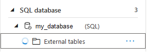

    I did not specified any error message, my issue is about Synapse that seems down when i try to vizualize my external tables ; screen of Synapse Workspace (the issue exists also in a database administration tool like dbeaver) :
