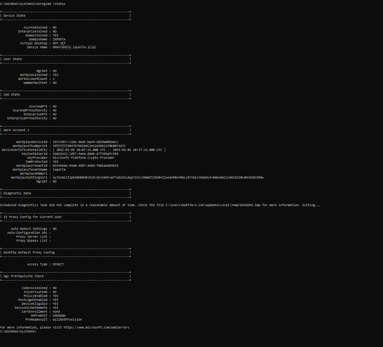

I also tried dsregtool, but not much of a luck.
Computer is domain joined.
Back to the Note 1: The device gets entra joined and domain joined, the dsregtool gets okay, but when i press 3 to get the output for whats wrong in Hybrid, it's says that it doesn't have connectivity.

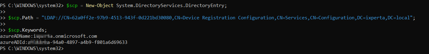

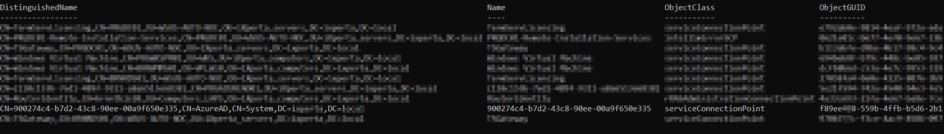

  2. Čako Martin 20 Reputation points
    2025-03-18T08:29:33.0966667+00:00
    Hello @Venkata Jagadeep ,
    thank you for your response, and excuse for my absence in the ticket.
    Here I provide some more things that could lead to solving this issue.
    What I think is missing in the DSREGCMD /STATUS is an executing account name (user), that could be a lead.

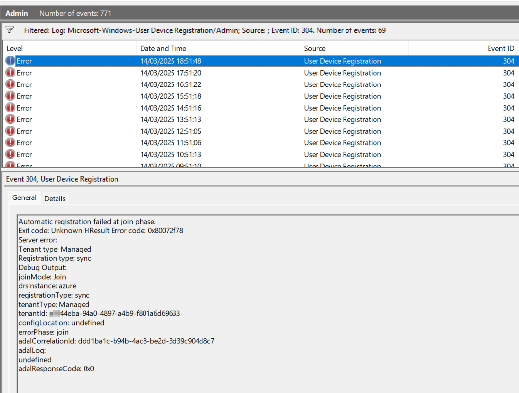

    EVENT ID 304User's image

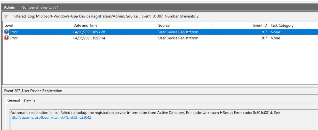

    EVENT ID 305User's imageEVENT ID 307
