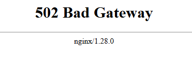

I am currently deploying a laravel project with Azure app service.
Code is on Azure repository and I set up pipeline to deploy it to Azure App Service.
When it's done, I checked the site and saw default "hostingstart.html" page.
So I wrote nginx.conf and startup.sh to the code directory and add startup command to run startup.sh file in configuration.
But the result is 502 error.
server {
    listen 8080; # or the port your App Service uses
    root /home/site/wwwroot/public; # Point to your Laravel public directory
    index index.php index.html index.htm hostingstart.html;
    location / {
        try_files $uri $uri/ /index.php?$args;
    location ~ \.php$ {
        # FastCGI setup for PHP
        include fastcgi_params;
        fastcgi_param SCRIPT_FILENAME $document_root$fastcgi_script_name;
        fastcgi_pass unix:/var/run/php-fpm.sock; # Path to PHP-FPM socket
cp /home/site/wwwroot/nginx.conf /etc/nginx/sites-available/default  # Copy your custom Nginx configuration
service nginx reload # Reload Nginx to apply changes

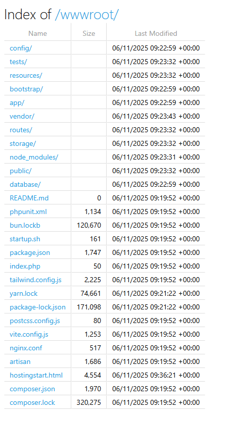

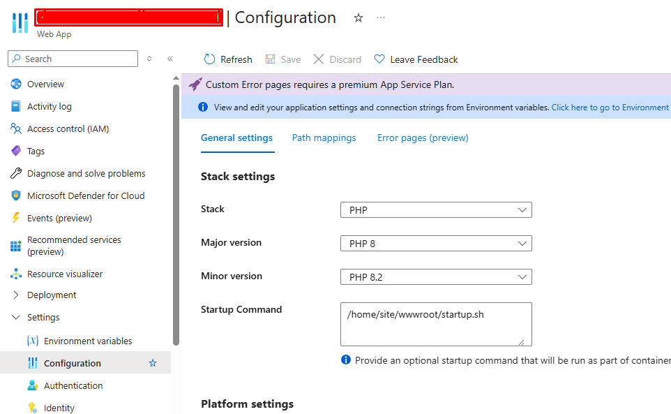

    From your screenshots, I can see:
    • Your App Service is configured correctly - You have PHP 8.2 selected as the runtime
    • Your Laravel files are deployed - I can see all the Laravel directories (app/, public/, vendor/, etc.) in your wwwroot folder
    • The startup.sh file exists - It's listed in your directory
    • But you're getting a 502 error - This is because your custom nginx.conf is conflicting with Azure's built-in web server

    Step 3: Configure document root for Laravel
    Since Laravel needs the /public folder as the document root, you need to add this configuration:
    1. Go to your App Service Configuration
    2. Click on Path mappings tab
    3. Add a new Virtual Application:
      • Virtual path: /
      • Physical path: site\wwwroot\public
      • Check Application
